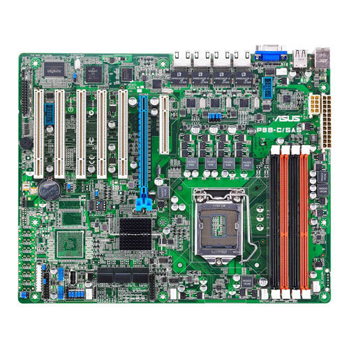

Intel board , core i3/Xeon E3 , 32GB , 5x pci , DSP opti.
P8BC4L...optimized for Native DSP-Cards PCI Support...
has anyone experiences?
i search a board for 3 cards...and pci-graphic (for the moment)

- P8B-C4L.jpg (89.79 KiB) Viewed 7218 times
Re: Intel board , core i3/Xeon E3 , 32GB , 5x pci , DSP opti
so far, no socket 1155 motherboards, ZERO, have worked correctly.
socket 1150 is fine.

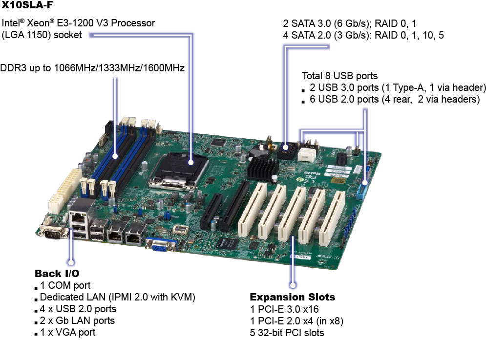

Socket: 1150
asus: not found (only 3x pci-32)
supermicro: found 1 board
this ok?
SuperMicro X10SLA-F
(status: 2014_05_24)
homepage: http://www.supermicro.nl/products/mothe ... 0sla-f.cfm
street price: http://www.idealo.de/preisvergleich/Off ... micro.html
- Socket: Single Socket H3 (LGA 1150)
- Chipset: Intel® C222 Express PCH
- PCI-32: 5x
- RAM: 32GB
- CPU: Intel Xeon E3-1245V3 - 3.4 GHz - 4 Kerne - 8 Threads - 8 MB Cache-Speicher - LGA1150 Socket - Box
CPU: http://www.intel.de/content/www/de/de/i ... 2c+4th+gen.
CPU-Datasheet: http://www.intel.de/content/www/de/de/i ... brief.html
CPU-street price: http://www.idealo.de/preisvergleich/Mai ... E3-1200+v3
Key Features
1. Single socket H3 (LGA 1150) supports
Intel® Xeon® E3-1200 v3, 4th gen.
Core i3, Pentium, Celeron processors
2. Intel® C222 Express PCH
3. Up to 32GB DDR3 ECC 1600MHz
UDIMMs in 4 sockets
4. Dual GbE LAN ports via Intel® i210AT
5. 2x SATA (6Gbps), 4x SATA (3Gbps)
6. 1x PCI-E 3.0 x16, 1x PCI-E 2.0 x4
(in x8), and 5x PCI-32 slots
7. 2x USB 3.0 (1 Type-A + 1 via header)
6x USB 2.0 (4 rear + 2 via header)
8. Integrated IPMI 2.0 with KVM and
Dedicated LAN
9. SATA DOM power connector support
10. VGA D-sub connector, TPM header
this ok?
SuperMicro X10SLA-F
- PCI-32: 5x
- RAM: 32GB
Key Features
UDIMMs in 4 sockets
Dedicated LAN
- X10SLA-F_spec_features.jpg (370.63 KiB) Viewed 7108 times
Supermicro is a first-class manufacturer. it's MUCH higher quality than Asus, MSI, Gigabyte, Asrock or any of the other gamer manufacturers. i would expect it to work quite well, especially with the XEON. you'll probably need to add the plastic backplane for non-XEON coolers.

great idea, i will dogaryb wrote:...send Supermicro an email asking if you need any additional hardware to mount a standard intel cooler for a non-XEON processor.
well, Supermicro makes boards for corporate servers. they're meant to run 24/7 and for a long time. gamer boards are made to be replaced regularly. gamer boards are only concerned with speed and flashy features. data integrity would be the primary concern for a commercial application like the Supermicro board was made for.Immanuel wrote:Gary, can you tell something about why Supermicro is better? Do they use higher quality components and PCBs? I don't run my PCs super hot, and I am used to long actual product life anyway (as far as I know).
I notice that the PCI-E to PCI adapter chip is the same as either MSI og Gigabyte uses. But that is just ONE component.
does any of this mean that one board would be better than the other? maybe, maybe not....but that board has a lot of PCI slots...
the customer service is usually quite good, as well.
I know the gal there by first name now since they even helped me redesign my 1U to accommodate another non Supermicro mobo.....
I keep telling them I want NGFF support and will immediately drop whatever I am using at the time, which is the latest ASRock w/ SAS and M.2 x 4.
So the support I receive from them is incredible and that's just from buying their chassis and 2 x custom PSU connectors, one for the MSI and now ASRock, as the chassis was meant for an older ATX mobo.
I haven't used a Supermicro mobo for years now but that DAW still runs Gigastudio really well w/ old Raptors, and I even sold the Scope cards and stuck in the ancient Lynx Stereo card from the late '90s.
I will drop the recent ASRock design and sell it as soon as Supermicro can get the PCI-e SSD M.2 connectors cranking at 4x speeds.
Those demons are so fast you can get the same latency as using your RAM for samples as one of these Samsung XP941s...
Plus a small mATX or MINI ITX can become a deadly DAW, expect to see these this summer.
Supermicro has an mATX board that rocks, but the only problem is the PCI-e SSD connector for M.2 is 2x, the same as our XITE-1 connectors. Fine for audio needs, but for streaming no different than the SATA III bottleneck @ 500+MBps.
