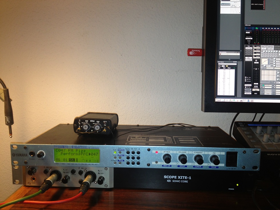

I did just buy one - and yes it is a beast. Very deep synth and I'm still trying to get my head around it.
I've been following the market price since I bought mine for 500€, which was a good price. For the past months I've seen several sell for 900-1000$/€ on ebay.

Finally decided to get rid of the Microwave 1 and keep the FS1r.
Drug it out with the SE-1X and have a 4U with FS1r and the SE-1X.
Will be using it lots so can share some XITE-1 and FS1r tricks soon.
