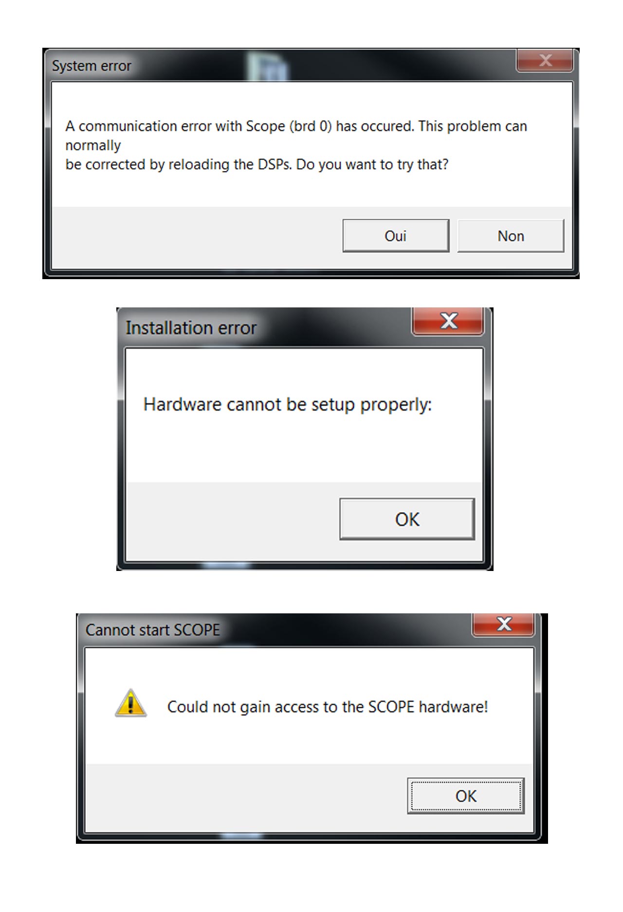

Now i've found a a scope card, i've bought the sc 5.1 version, got new keys.
I have installed the card, the drivers was installed perfectly and the sc platfrom too !
When i launch the program, i've got 3 succeciv message (see pic)
i've tried to install the card on 4 different pc, seven 32bit, seven 64bit, xp..
Nothing work, same message..
I 've try to contact sc team and they told me the card was dead
How do you think of that ?
Is someone know this kind of problem ?
Do you think the card is really dead ?
Thanks for your reply

Re: scope with sc5.1 64 bit instalation
what is the software telling you in those warnings?
Scope does a check on the card(s) when starting. if the card does not respond properly, Scope won't start.
those warnings are telling you that the card is not responding to the software.
there are a few possibilities.
1. the card is not truly and fully seated in the slot.
2. the slot on the motherboard is dead or disabled.
3. the card is dead or disabled.
4. the card is dead.
5. the card is dead.
the last Scope card was made more than 6 years ago. some are bound to die. it's crappy, but...
