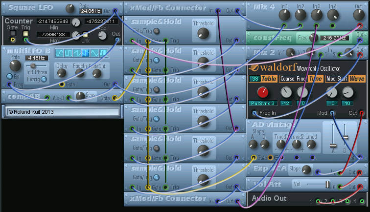

For over 25 years I love the Sample & Hold module as a pattern creating device.
Before we were spoiled by Tiger, Cubase and other sequencer programs.
I like the freedom in creating patterns with the module.
Here done by LFO triggering and, most important, feedbacking the 2nd lfo control value loop.
Cascaded S&H.
Have fun.

Aka the Psuedo-Random Sequencer, or LFSR (Linear Feedback Shift Register)...a preloaded value gives you a new seed to start the pattern, and taking a different "tap" as feedback gives a whole different set of patterns
