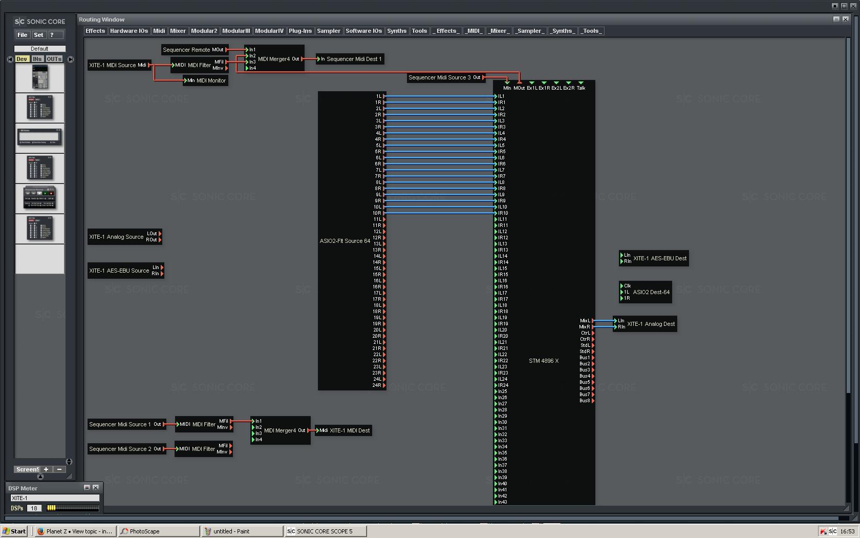

Re: installing xite1 folder
If you've enjoyed Scope then there's no way you won't enjoy XITE-1. Just more of the Scope goodness. It's also nice to get it out of the computer into a separate unit.
If you look at my screenshot I arrange freebies and older stuff in folders similar to the original Scope names, but with a "_" to push them all to the right hand side of the menu bar. This means I can easily copy over old stuff when installing without trying to figure out where it all goes.
