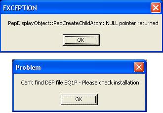

Hi,
i can not use the PEQ4 M/S Effect.
Thank you

The dsp file EQ1BP.dsp is missing from your dsp's folder.
You need to copy the attached file(first extract it from the zip archive) to your scope/app/dsp folder and restart scope software.

The dsp file EQ1BP.dsp is not missing from the dsp's folder.

sorry, your missing dsp is eq1p, not eq1bp, try the new attached file, it contains all dsp's needed by the eq, try to copy the missing one which is EQ1P.
The needed dsp depends on the filter type.

make sure that the file doesn't end up marked "read only" on the properties page(right click on the file and choose "properties"). if it does end up "read only" uncheck that box and apply...
