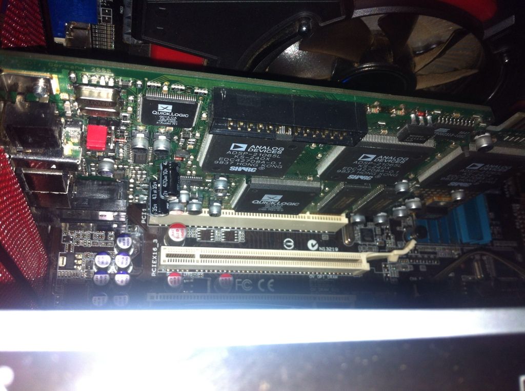

Re: Sonic core soundcard setup
@garyb says, you can count the number of SHARC chips ( commonly referred to as DSP chips) -Wrighty wrote:I don't know how would I checkdante wrote:Manuals are here:
ftp://sonic-core.net/manuals/SCOPE/Manual/english/
What card do you have?
3 DSP chips = LUNA
4 DSP chips = PULSAR 1
6 DSP chips = PULSAR 2
14 DSP chips = SCOPE PRO

Decided to just take a pic..
Luna. 3dsp.
