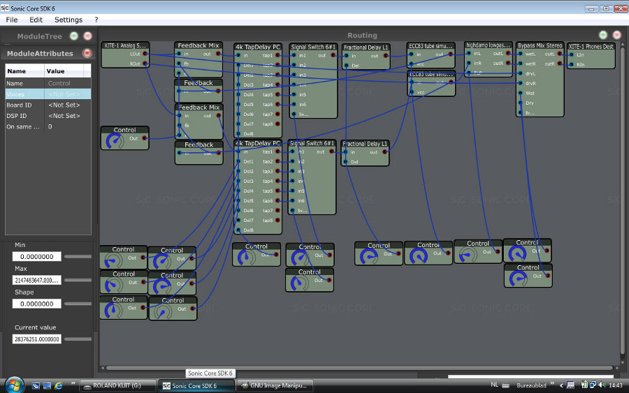

When patching stuff I want to delete/change a module. By deleting not all, but some of them, SDK6 stops working.
How come?

Post by Roland Kuit »
No, just by deleting one module. And it depends by which module I'm deleting.
F.i. I was creating a Glitch Delay. So I needed the Analogue In and the output to the headphones.
Deleting the Analogue In causes(every time) stopping the SDK6 software.
I get a windows failure: DEP problem, but I can't change that.
Sometimes I have to start up Windows again after this failure.
