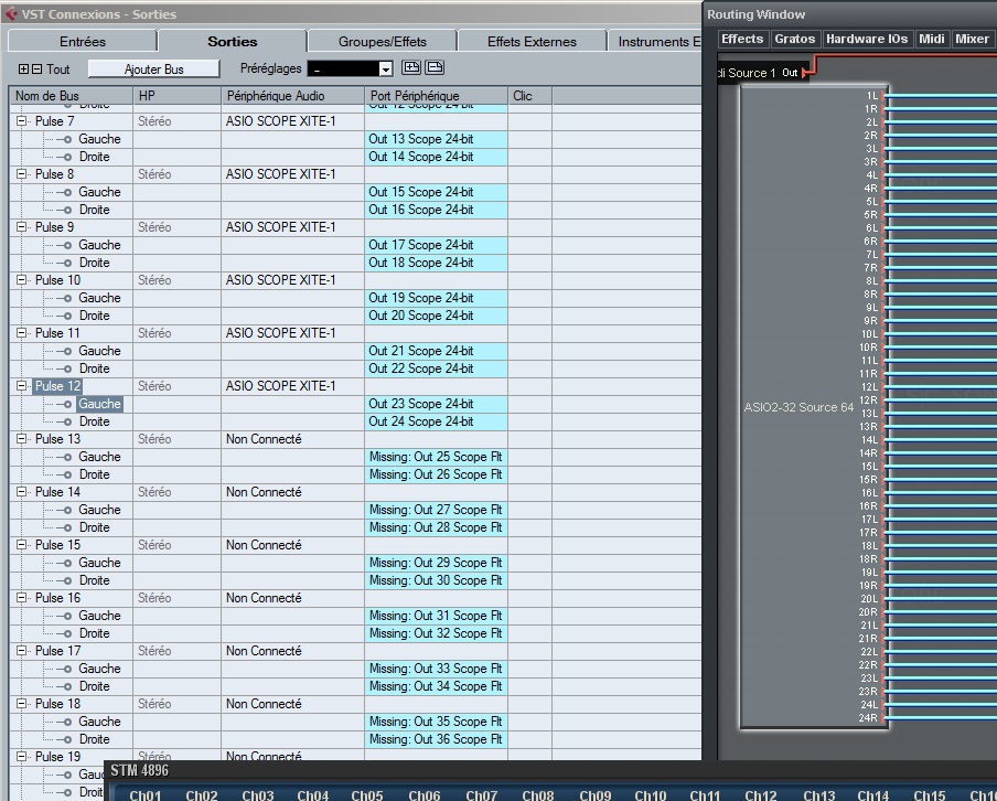

It a little bit strange because when I load asio2 32bit int in Scope, it's written 'out Scope 24bit' in Cubase...
Is it 24 or 32 bit ?
I would prefer to record on 32bit, of course !
24 or 32.jpg (254 KiB) Viewed 8524 times
Re: PLAY/RECORD plugin?
So ?
Are the Cubase asio output 24bit ? 32bit ?
Does asio 32bit source module say to Cubase to display 24bit instead of 32, like someone forgot to correct when building the module ?
I vote for a real 32bit module wich make a joke to Cubase.

I guess that's how Cubase recognizes Scope inputs and outs. Remember 32bit is really 24bit. When you are recording music you're recording at 24bits, so that's probably why Cubase is seeing Scope 32 bit sources as 24bits. I don't like or use Cubase. Also, Cubase and Creamware didn't really like each other as companies but Cubase, especially version 4.5 will still work great.

I switched to Asio2-32 today.
My DSP-Meter honored this with a decrease on DSP #2: From 78% sync with Asio2-Flt down to 60% !
But i was'nt able to use this with Cubase. Cubase showed all connections with 24 bit, but there was no sound. Nothing, no input, no output. Silence. I restarted everything and even installed the XITE-driver again. I remember that this Asio2-32 worked some years ago. Maybe this problem came with one of the Cubase-updates since then. Or the upgrade from Win 7 to Win 8...
Now i'm back on Asio2-Flt and everything is fine again (78%).
If someone's interested, my system: Windows 8.0 64bit, Cubase 7.5 64 bit, XITE-1 driver vers. v5.1.2709-x64_DE (2011)
If you change asio module in Scope, you have to set them again correctly in Cubase vst connexions and in the asio Scope driver of the device manager too.
I don't see why it wouldn't work well.
