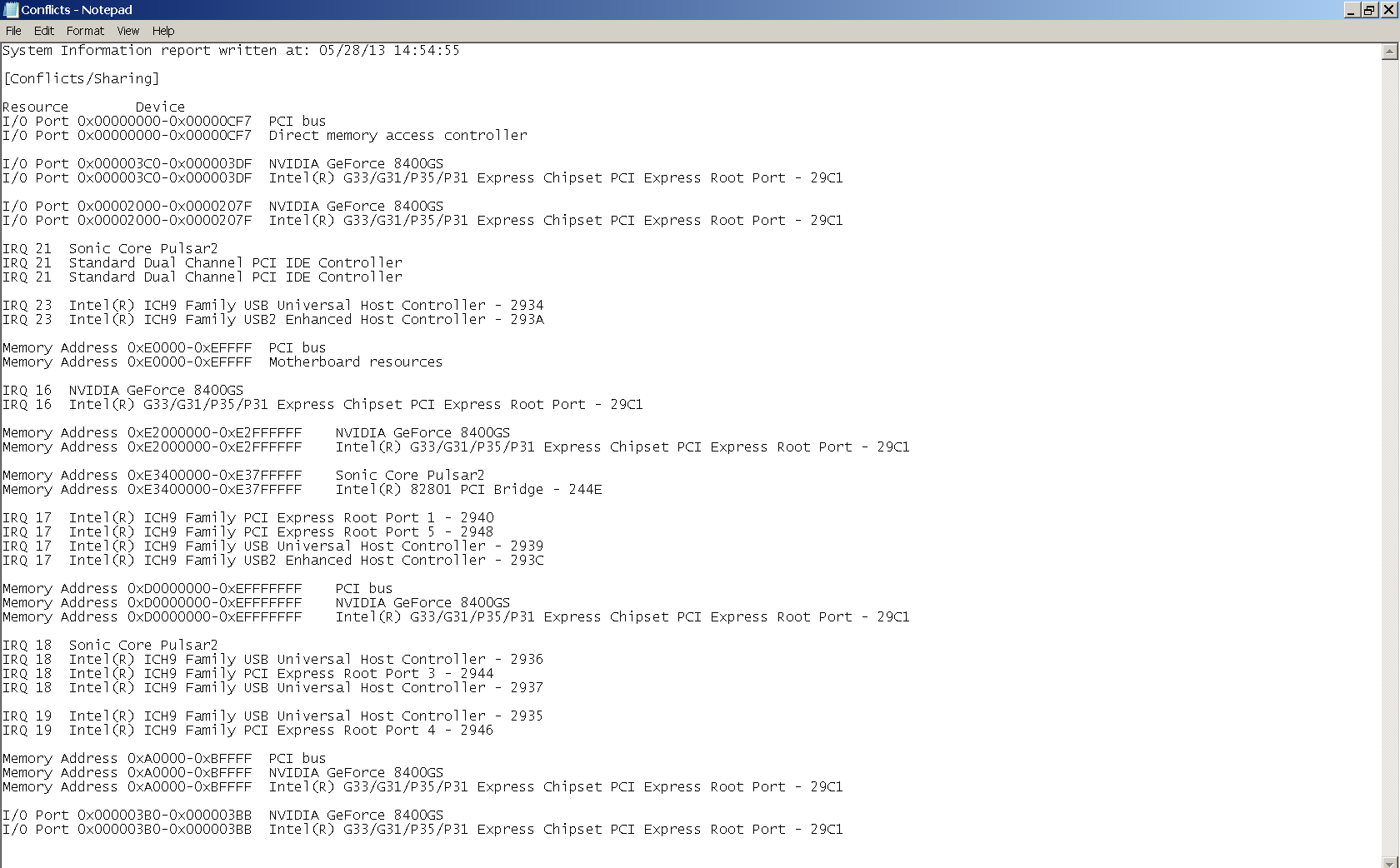

I've started using Windows 7 and recently tested it with latency monitor and have notice a few problems.
I've monitored it also with windows Performance monitor, which is really good. It shows me a lot of IRQ activity when I use my USB mouse and USB keyboard and I think it may be to do with IRQ conflicts.
Also one of the Scope cards is SHARING AN irq with PCI IDE Controller, which holds my main O/S hard drive with samples.
Are the IRQ conflicts the main problem here? Would putting every USB device through a single USB port help? I wanted to add wifi so that I could use the Ipad as a controller. Also my Axiom USB Midi keyboard controller seems to cause some instability. Again is that the IRQ conflict?
- Conflicts.png (88.14 KiB) Viewed 2529 times

the PCI and PCI express ports are probably fine. you do need to disable USB controllers 2936 and 2937.
that will leave you with 3 or 4 usb controllers and 2 enhanced usb controllers which is plenty.

they're hard to assign because there need to be so many for all the crap that we like in our computer. the physical reality is that there wouldn't be enough irqs at the hardware level. windows MUST handle the assingment or your computer wouldn't work peoperly. systems were much simpler in the win98 days.
set it up as i suggested and it will work as well as it should. every system has it's limits. if you can't make good music within the limits of that system, then i just don't know what to say other than buy one of the newest systems and an XITE...

Ye seems fine now Gary. I tried to add Wifi so I could use the Ipad as a DAW controller (really useful by the way) and it started to go a bit ape! Has been stable for a couple of years but these USB ports seem to be a pain because I have the axiom 25 running on the ones you told me to disable.garyb wrote:
have you actually tested your performance with the actual apps you are intending to use? if you turn off all the win7 eye candy, you may have plenty of power regardless of what the DPC app says.
I've just ordered a wireless mouse/keyboard set and a USB hub so I can run them off one port.
Could you tell me why disabling one port stops 2 of the inpur devices? Are they connected in sets of two?
Thanks for your help.
Re: Audio Glitches - Windows 7 Intel DP35DP
you are disabling controllers, not the ports themselves. a controller may handle more than one port.

Gary, I have it running smoothly again. DPC Latency checker showed everything was ok but Latency driver showed problems but was part of the culprit.
The OS drive was clogged up and I deleted some data. There was a lot of junk from updates etc.
There is an odd glitch if my ULLI is low and I believe the main culprit is the Nvidia 8400GS and the reading/writing of the hard disks.
