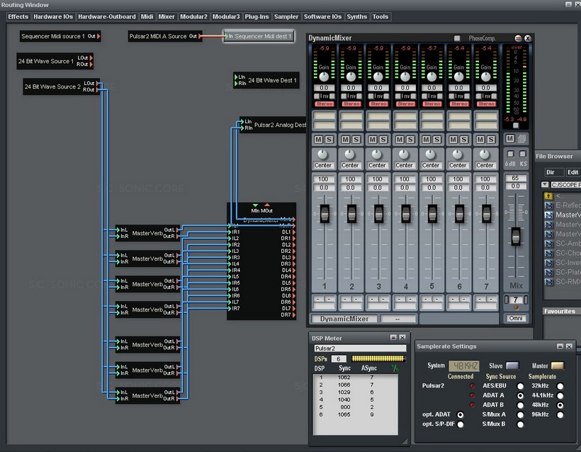

6 MasterVerb Classic without PCI limits warning. (what's the difference with the other Masterverb? I see it uses less DSP power).
With difficulties I made to connect to the mixer also the 8th but after some retries I made it play with all the others.
Of course I reached the available DSPs power, so couldn't go on.
Closed it and reloaded the saved project: it opened without any PCI limits warning and the audiofile played through all 8 units without problems.
I think it's a bit weird it doesn't give warnings at all.

B75 Masterverb Classic Test 8units image
B75 Masterverb Classic Test 8units reduced.jpg (145.06 KiB) Viewed 7208 times

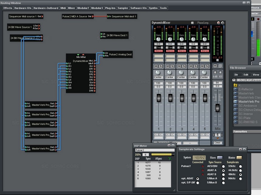

2 Masterverb PRO without getting PCI capacity limits warning.
Got it loading the 3rd one, but didn't get it loading the 4th one.
Got again the warning loading the 5th unit.
Anyway it plays fine the audiofile through all the 5 Masterverb PRO units.
Then I had no more DSPs available.
Again saving and reloadind the project I got DSPs warning and empty bar and no sound: resyncing the Master brought Scope on service again and played soundfile fine through all 5 units.
Reloading again and again these two projects (even the day after), with Hypertherading off or on, I got same behaviour.

B75 Masterverb PRO Test 5units image
B75 Masterverb PRO Test 5units reduced.jpg (115.24 KiB) Viewed 7208 times

But I wouldn't let the Reverb test disappoint you. I used 3 x Pro's and 9 MVPs was all I got , but I had Solaris, B2003, Modular, effects and Prowave rocking with headroom left.
Personally I actually prefer an external Hardware Reverb, they just seen to be more overwhelming in encapsulating the audio source.
A great Reverb that would be easy to run using 50 dollars for conversion tools in ADAT, and it's the Alesis Q20.
If one had an A16 you could run a pair of these, then a pair of hardware pedals like the Moog 12 Stage, Moogerfogger, or Rind Modulator.
Just talking out loud, and obviosuly another addicted Scope lover.
