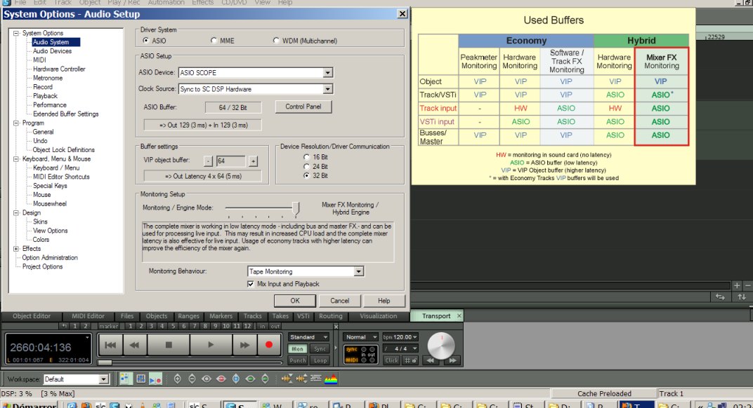

I don't know if the software monitoring is active in Samplitude I choose the mixer fx monitoring (so i think it's ok):

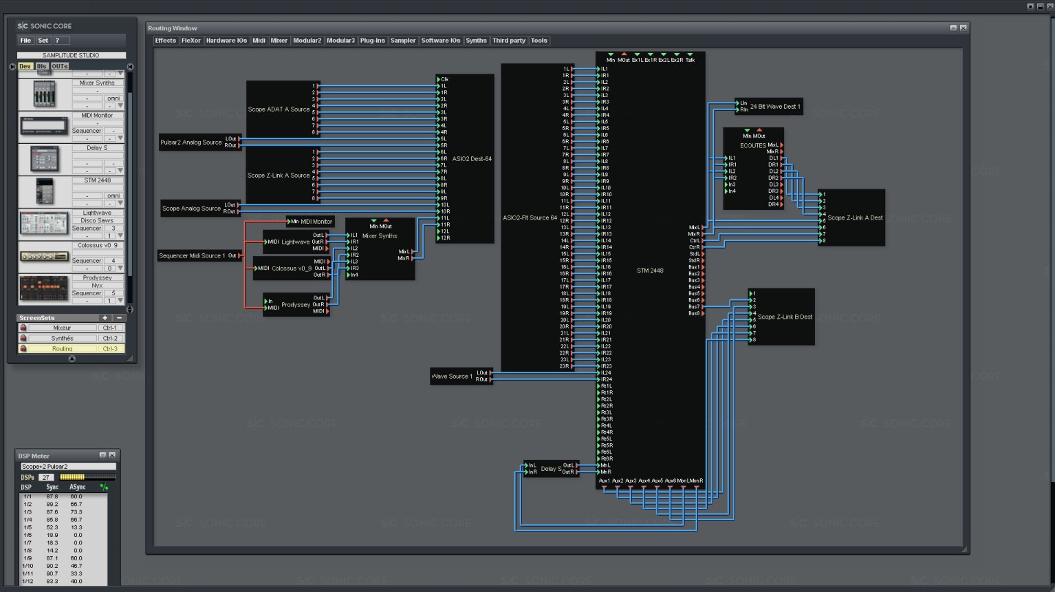

Maybe something inside my routing (I don't think so)
