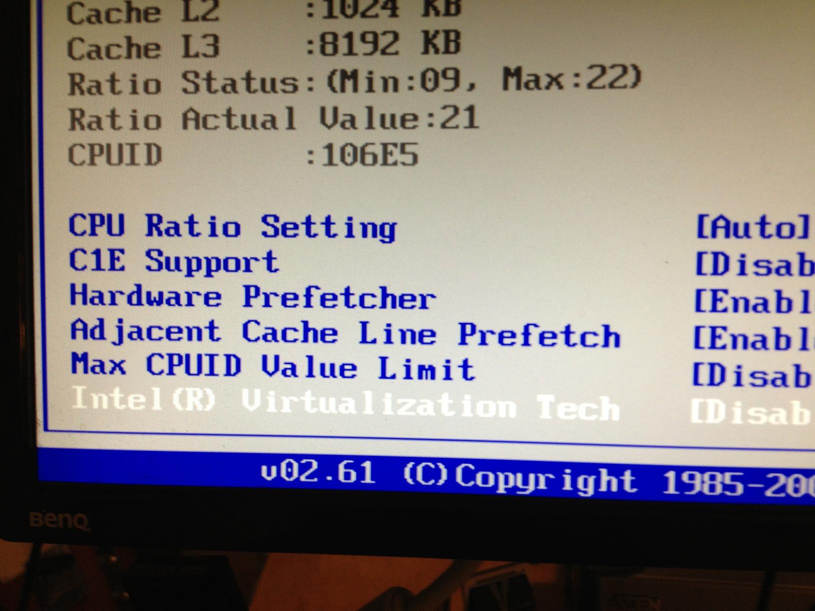

I want to know if the CPU Ratio Setting ,
thats on Auto maybe schould be disabeled also.
Hardware Prefetcher and Adjacent Cache Line Prefetch maybe schould be left enabeled ,
or can you tell me.
see pics.

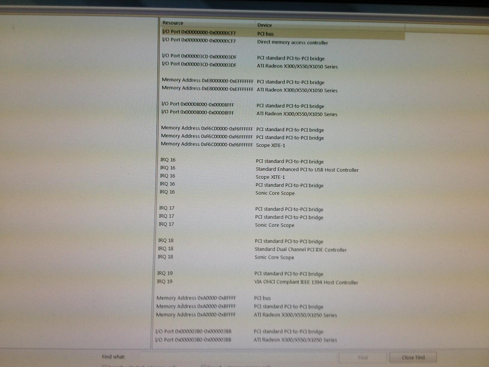

In the other photo is maybe what you refered as AMD ???.
Its from System Information /Conflict /Sharing.
Can you see anything I schould do.

leave the cpu ratio setting alone unless you know exactly what you are doing. you can ruin your hardware playing around.

Thank you but what about system information\conflicts/sharing then.garyb wrote:leave the cpu ratio setting alone unless you know exactly what you are doing. you can ruin your hardware playing around.
i would put the XITE into a different slot.
Maybe you can see something ,and you think I shall be on another computer with Xite or what,
because the other express slot is probarbly the same on this computer .
I dont really understand .
Is there anything with Xite that gives thouse dsp varnings on PCI Scope.

shared irqs are not good. shared irq with USB cannot happen.
try the XITE in a different slot and then see what is shared. at the very least, you need to disable the USB controller that is shared in the device manager.

Thanks.garyb wrote:shared irqs are not good. shared irq with USB cannot happen.
Is that on IRQ 16 , exactly how do I do that in the Device Manager.
There is two called that shall I disabel driver for both or what
We have a switcher that is using usb ,
and the usb controler will work in anyway then .
Ok I disabeled it and it disappeared in IRQ 16 so.

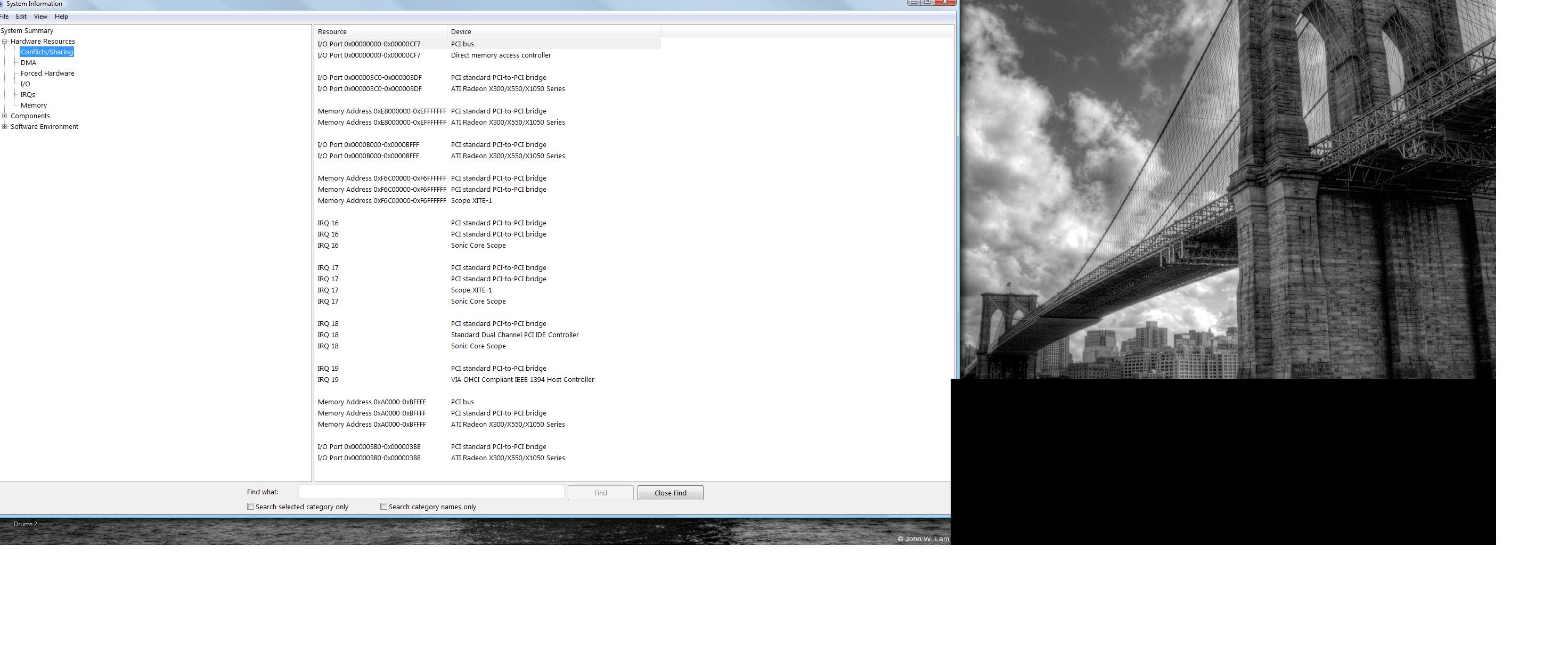

I just disabeled it .
I also switched Xite now.
Is this better
I want to find that open PCI Express and turn off "Limk State Power Management,
or similar for Vista.
I have chosed High performance and maybe its more, but never sleep of course .
PCI Express is maybe somewhere else

yes it is better.
