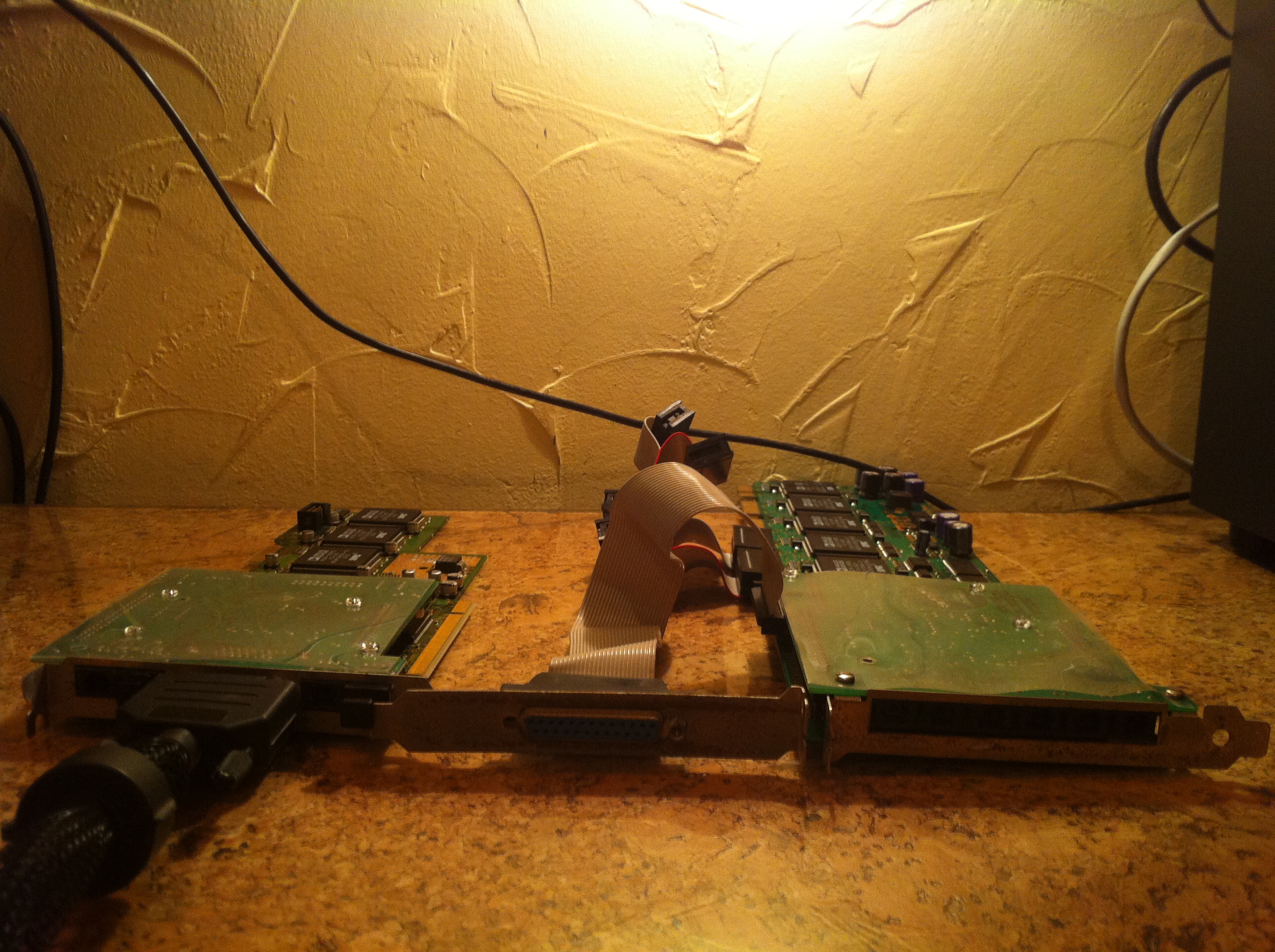

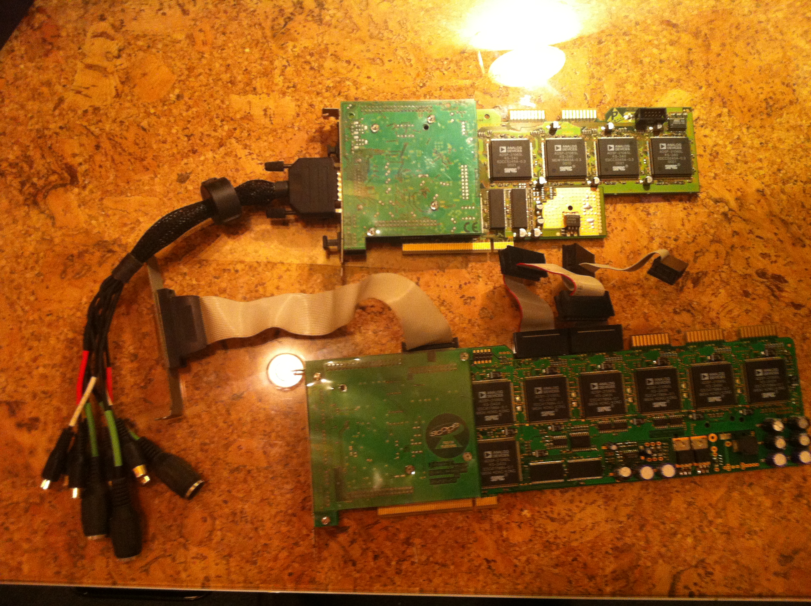

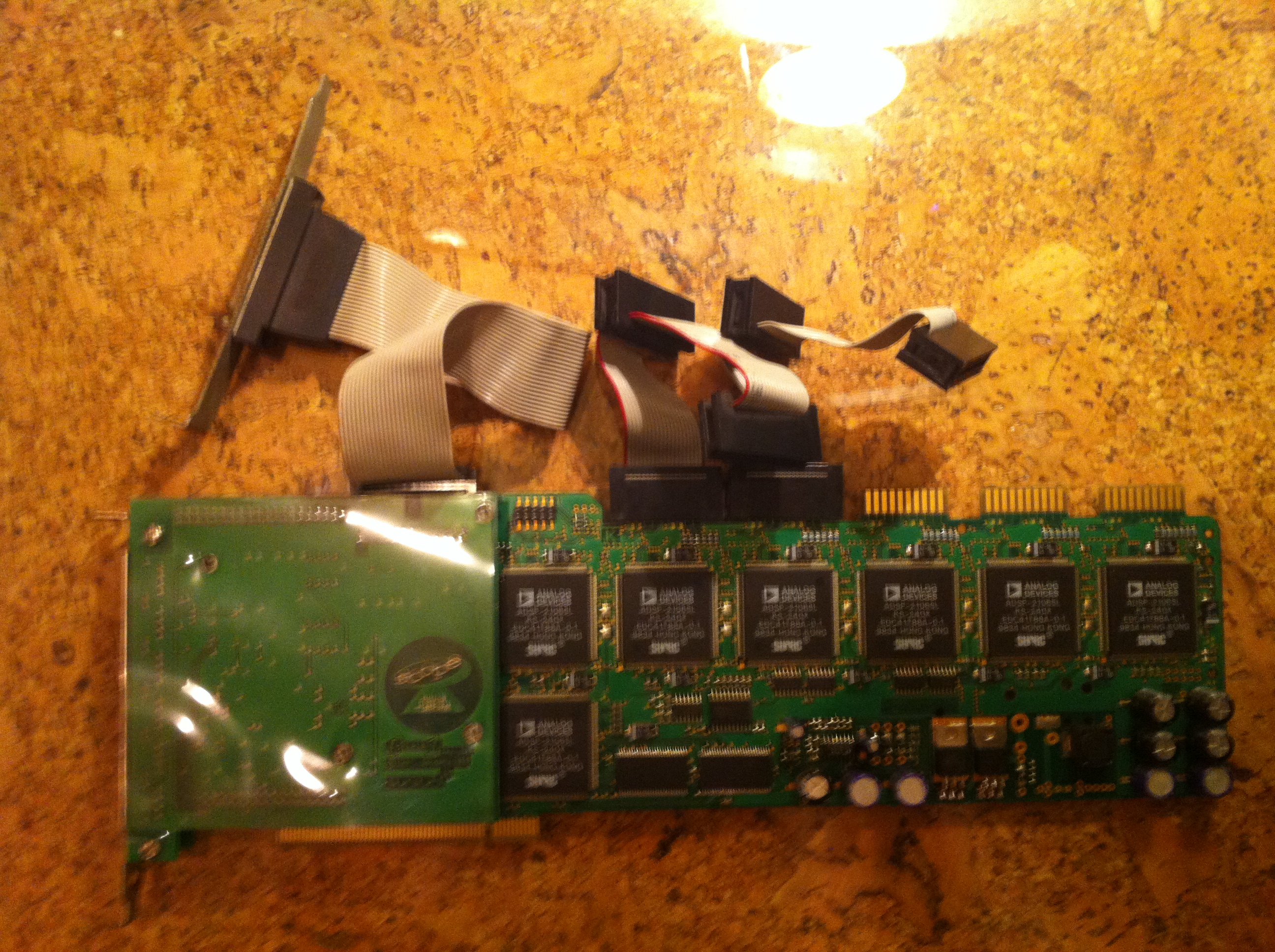

hi all
the guy send my photos of the pulsar 2 + mystery card.
so what card is it?
תמונה (1).JPG (2.11 MiB) Viewed 2330 times
תמונה (3).JPG (2.34 MiB) Viewed 2330 times
Re: physical difference between scopeS/P and power pulsar
whoever you buy from should give you the keys.
that looks like a first generation Scope card. it won't work as well as a 2nd generation card like the Pulsar2, but extra dsp is pretty cool.
stability? Scope is like a rock if the machine is setup correctly and the card isn't broken. can you crash it? sure, it's part of a computer system. what will crash it is known and repeatable, so if you have problems, they're likely your fault and more than avoidable. in normal use, it's the most stable thing in my computer.

i am planning to install it on an old machine with xp and no sequencer to be used.
so this is not an S/P or power pulsar? what does it mean 1st generation? how many dsp does a scope card has, this looks like about 10 dsp.
and does anybody has a serious answer about the "why do i need dsp?" question. i know it sounds dumb, but i would appreciate a serious answer
why do you need dsps?
to run realtime audio devices!
it's 15 dsps.
