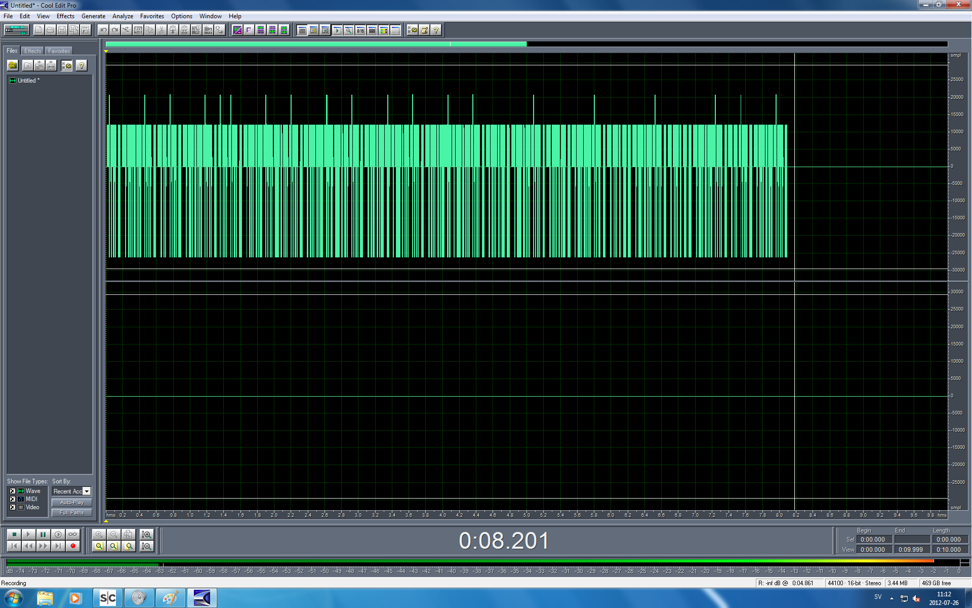

One picture is of a recording of the noise. It's supposed to be completely silent and instead this appears. The noise is not consistent. Sometimes it's more silent, sometimes it's unevenly distributed between the stereo channels. Sometimes I actually manage to make a recording of what I want to record but then it's broken up by these spikes that you can see in the picture.

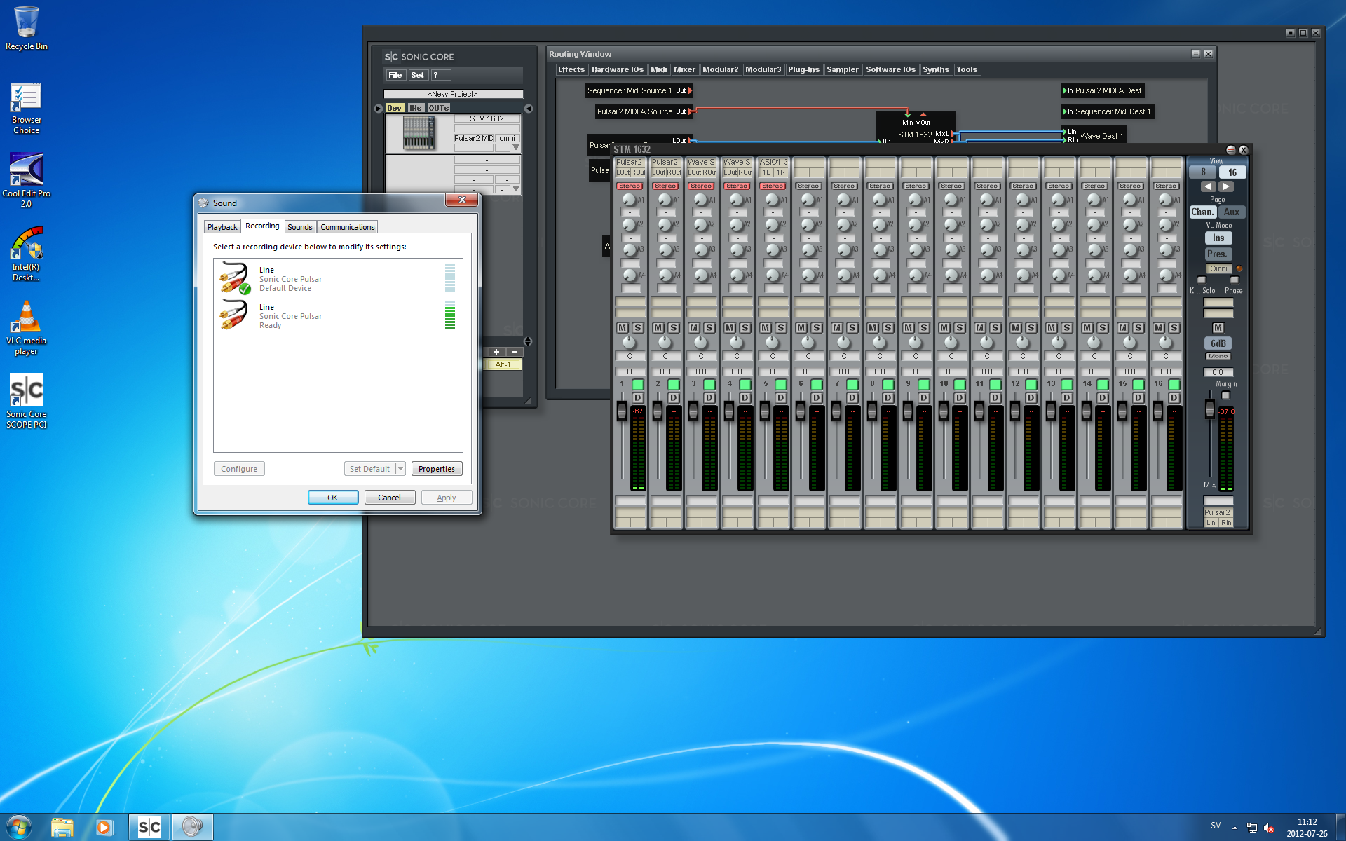

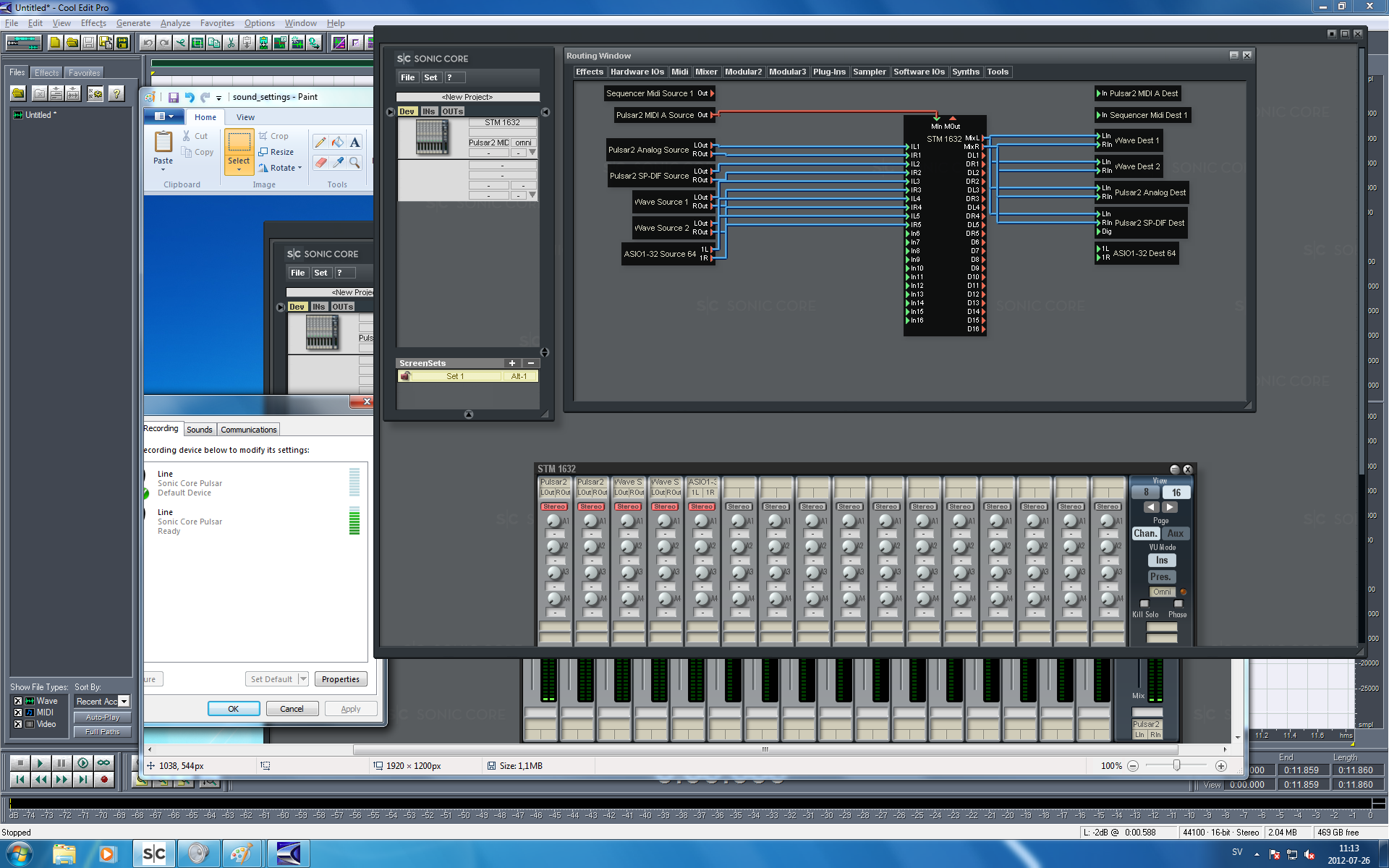

Another picture is of how the main mixer of the Scope 5.1 routing setup looks like. No noise except for some tiny DC input from the analog input. The noise is still there if I just have a wave source and a wave dest so it's not related to that. Besides, that DC signal is there in Windows XP and Windows 7 32-bit too and in that case there is no problem.
In this picture you can also see how the Windows sound recording settings look like and the VU meter for the recording input. It's constantly offset and correlates to the noise level that I record.
The final picture is of the Scope 5.1 routing environment just to show that I'm running the default settings. It's a fresh Scope 5.1 install.

- This is how the sound recorder settings look like. Observe the constant level offset in the record input VU meter.
- sound_settings.png (1.12 MiB) Viewed 9086 times
- This loud noise is present when you try to record silence. Nothing is played back in the system at all.
- recording.png (279.31 KiB) Viewed 9086 times
- This is the set up in Scope 5.1. Everything is default. Nothing has been set up.
- routing.png (426.29 KiB) Viewed 9086 times
