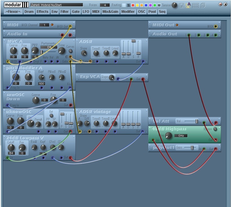

Thanks for replying so soon. Here is a screenshot of the synth.
İ dont know maybe it is because the oscilators are running all the time and they dont start up from zero each time they get triggered. İ dont want to mess around with the attack time to preserve the punch because no matter how little i try i can here the difference and it bothers me. Btw is there an osclator that can sync the start?
And again thanks for replying.

Re: OSClator is clicking on keyon??????
Post by jhulk »
the first problem is you have poly set to 4 if you press more than 4 notes you get poly stealing which it will take from the envelopes
you need to add an esync as you only have the amp envelope with esync and not the filter envelope
