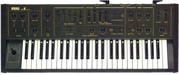

Underrated in its day, a 'string machine' with a synth section as well. It has several strengths such as full polyphony, simplicity and instant layered gratification. Plus a unique sound somewhat like a cross between an organ and a synth, possibly due to the synth section having additive square oscs w/ sliders like a drawbar configuration (16', 8', 4' and 2').
....character makes up for simplistic synthesis
The original never had MIDI or patch memory, so bringing it into a modern day replica with these added, could be popular as Im reasonably sure it hasnt been done yet (except maybe only sample sets ?). I would pay as much for this as any mid range Zarg synth.

Does it sound very different or better than a ARP Omni or Quadra ?
I had all kind of string machines in the past, ARP/Solina, Roland RS ?, Logan String Melody and Yamaha SS30,- but the only I really wanted, the Freeman String Symphonizer, was never available in my country.
None of these had a "synth section" though ...

Doubt it sounds like either of those. I'll post something on SoundCloud later from the '80s.
Meanwhile go here to hear : http://www.soundboard.com/sb/Korg_Delta_sounds.aspx Sounds 5,6 and 15 remind me most of it.
Also it featured in this jam I posted here http://soundcloud.com/hitfoundry/hanging-in-the-window a while back, dueting w/ a JP4
Specially it had a trigger socket on the back that I hooked to an 8 bit computer pumping out some rhythmic pulses - very unique sounding.

Just had a listen,- now I know how different it is compared to the other string organ desktop-hooters !dante wrote: Meanwhile go here to hear : http://www.soundboard.com/sb/Korg_Delta_sounds.aspx Sounds 5,6 and 15 remind me most of it.
Has personality and the filter sounds quite good.
I wonder if that can be done in Modular though.
