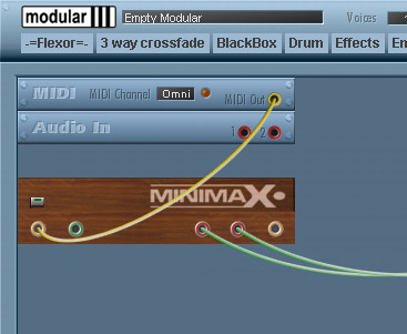

hi,
just embedded the minimax into modular module.
Just drag it into your modular shell and connect from left to right:
midi in, audio in, audio out L/R, midi out.
The button on the top left is to open/close the minimax surface.
CC83 is reserved for opening the surface.
Scope v5 serial needed.
p.s. since the module is protected and there is not polyphony control on its surface, i have added polyphonic modules, 3. 6. 9 and 12 voices.

This looks very interesting indeed. Maybe I'm just a modular noob, but what do you gain by having the minimax inside modular like this new module now makes possible? How is this different from just routing the signal from a Minimax outside modular into modular and then manipulate it in there?
Cheers,
Thomas
djmicron
Posts: 1181
Location: Milano
Re: minimax modular adapter
Post by djmicron »
the difference is that you can save the modular patch independently from the scope project, so you can have a chain of synthesizers inside one modular patch and this will make more sense when i'll upload other synthesizers adapted for modular.

petal wrote:This looks very interesting indeed. Maybe I'm just a modular noob, but what do you gain by having the minimax inside modular like this new module now makes possible? How is this different from just routing the signal from a Minimax outside modular into modular and then manipulate it in there?
Cheers,
Thomas
tip for xtc mode
once u create a modular pach with the synth in it and assign all cc to the noobs and save the modular the cc will be recalled in xtc mode oderwihse u need to save the cc definitions and reload on each project load for normal synth's ....
lg widy
