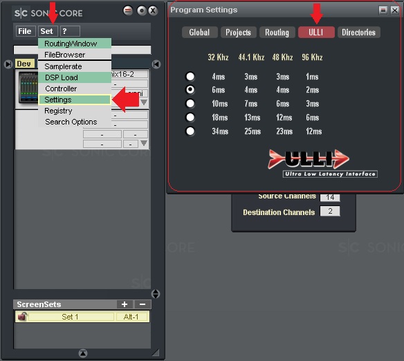

The buffer settings are responsible for the lateny. The lower the latency , the lower are the buffer settings and vice versa. You can only change these settings in Scope, via ULLI settings, not in the host.
Re: asio buffer size help
Sorry to be abit quick, but they are basically the same. The setting shown on the picture give a buffer size of 128. Raising it one level gives 256 and so on. You can verify by changing the latency, then view your cset.ini file (in scope folder -> app ->bin) and read the line in the beginning saying intBlkSize=(then the number of samples).

ahhhh its like that, it was in front of me the whole time , thnks guys!
