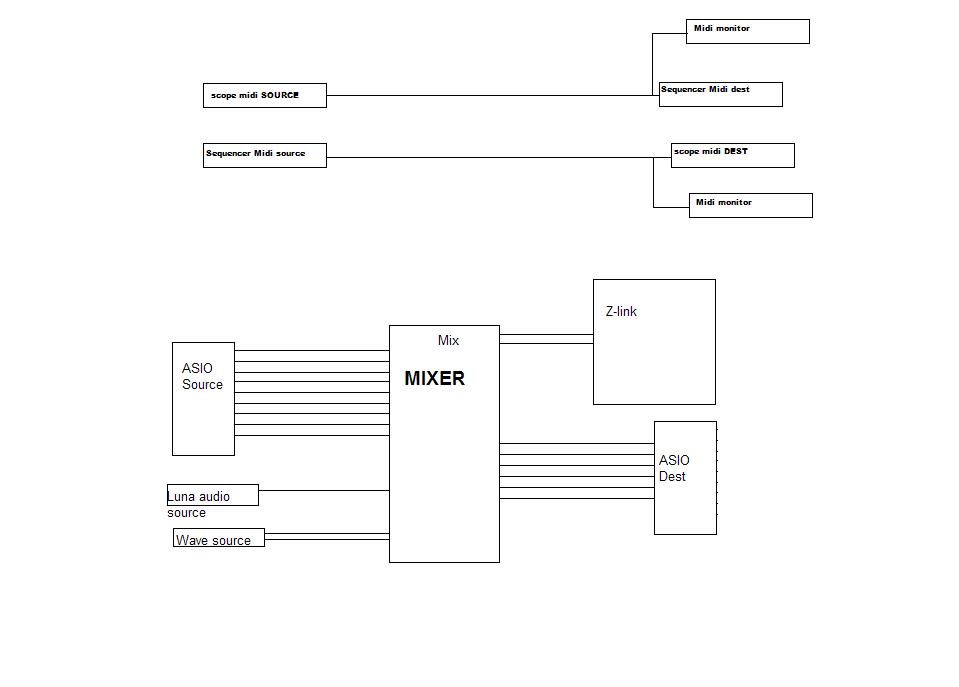

Yesterday I have lost midi devices in cubase, sonar, standallone applications, and everything that uses midi.
In scope I have connected midi like so:
Luna MIDI source to Seq MIDI destination, and Seq MIDI source to Luna MIDI dest.
When I put midi monitor to Seq MIDI destination I have a MIDI signal.
But when I put it to Seq MIDI source, nothing.
I have used this kind of setup for 2 years now and never had a problem.
I have tried to reinstall Scope bud with no results.
Audio and ASIO works great but non of the applications can not see MIDI inputs and outputs devices.

Luna MIDI source-------------------------------------------------------------Midi Seq dest
----------- Midi monitor (signal OK)
Midi Seq source---------------------------------------------------------------Luna MIDI dest
----------- Midi monitor ( NO signal

Re: Luna 2 no midi device problem
It is my main window.
I am not at home to put a screen shot.
- untitled.JPG (34.83 KiB) Viewed 883 times
i need screenshots of the midi and audio device setup in cubase and your project. a flowchart doesn't help. also, i know you're a vet and this is a stupid question, but you have the sequencer midi modules in the routing window BEFORE opening cubase, right?
Hi guys.
Thank you for all your help.
I AM THE STUPIDEST PERSON ALIVE!
I was optimizing windows for audio performance and shut down some services.
That was causing the problem to my midi.
Now I've turn some services on and everything is fine.
