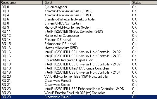

Re: STS 5000 freezes SFP 4.5
This is my IRQ configuration.
Is IRQ23 a problem ?
If so, what can I do ?
- IRQs.jpg (53.74 KiB) Viewed 3263 times
first, you can try disabling the USB controller 24DD in the device manager. that will probably fix the problem.

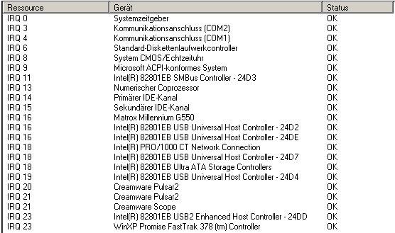

OK: If Gary is asking me about IRQ sharing it IS actually a problem.
After checking the mainboard manual, I
- disabled the IEEE 1394 host controller
- moved one of the 6 DSP cards from PCI3 to PCI4.
(I need the 378 RAID controller so I cant disable it to get the IRQ 23 free)
So this is the hopefully better config now:
- IRQs_1394_Controller_disabled_IRQ1_4_5.jpg (51.12 KiB) Viewed 3259 times
