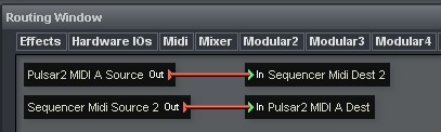

Hi guys,
I can't seem to get this program working:
http://miditest.earthvegaconnection.com/
I've created a loop in my problem board - Midi in to Midi out but MidiTester says it can't see the connection. How does the program recognise the ports?
Thanks
Posts: 8467
Re: MidiTest on Scope boards
your routing windows should contain the construction as wired below (with your port numbers).
you may need to select from the API dropdown list.
On the screenshot 'kernel streaming' is highlighted, if that doesn't work something like 'multimedia' or MMI would be a valid option (dunno how it's programmed)...
