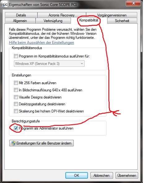

Re: 8 x 1 MIDI Mixer
x64 driver is unsigned->
you need to press F8 at win 7 startup and select
->prevent from forcing driversignatur<-
->Erzwingen der Treibersignatur verhindern<-
open SCOPE/XITE application as admin_
tell me if it helps;
good vibes
good vibes

signed driver files do not need F8;
as far as i know DAS plugs are already signed;
signed files only need to be opened application as admin;
if you get tired of clicking right mouse all time after boot do a right mouse click -> properties and select ->
x64 vibes
there is a x86 version in the zip too btw.
x64 vibes
