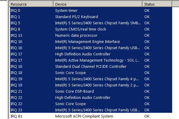

OK - my new system is now up and running, but two of my Scope cards are sharing IRQ with other stuff:
I've Googled away to find out how to change IRQ's in Windows 7, but it seems that this is no longer possible, I am only left with the option of prioritizing the devices sharing the IRQ and disabling devices. My problem i's that I'd prefer to use both the internal sound card (HD Audio controller) and I guess I can't do without the "Standard Dual Channel PCI IDE Controller".
Please - I need some help here, what are my options?
Cheers,
Thomas
Re: LGA1156 - any recommendations?
the ide controller is likely not needed unless you are using the ide connector. otherwise, it probably won't give you trouble.
the onboard audio should be disabled, sorry...have you disabled devices like serial and parallel ports that won't be used in the bios?

Yes, I have disabled everything I knew I woudn't need, like the serial port and parallel port.
I'd hate to let the onboard audio controller go though. Isn't there any way I can change those damn IRQ's?
Thx,
Thomas
