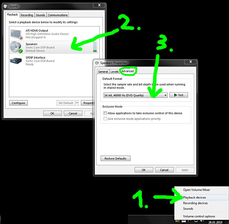

right-klick on the speaker symbol, then:
don't change samplerate while mediaplayer is running. i had a bluescreen when i did.

pling - when i go into my sound properties i dont get an advanced tab in properties, only General & Levels

aum7 wrote:pling - when i go into my sound properties i dont get an advanced tab
did you check the analog out's properties? spdif out has no advanced tab.

yeah i checked the analog properties, no advance tab or sample rate settings there
