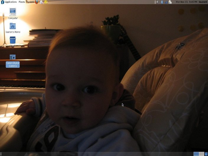

i decided to try a new hd on it, namely a seagate 250gb momentus 7200 rpm drive (the one which just dropped a pile of shit on the floor had a 5400rpm hitachi(e))
installed fedora 12 and voilà, the thing is blazing fast despite its long beard and abundant fleas
faster than ever before
like 3 seconds to boot gimp :o
