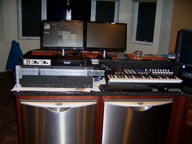

Works flawlessly so far! Sequencer/DAW software to come next...stay tuned, but the XITE likes it's new home... :wink:
Yes...I know It's my kitchen...all of you you can stop laughing now....I just didn't want to wait any longer...so I just started throwing the hardware together... :lol: :lol: :lol:

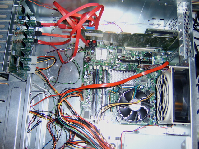

Added a Pulsar II card, installed 5.0 PCI. Once again, the board performed perfectly.
Joel
