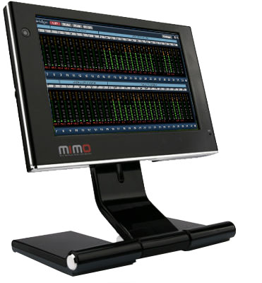

Hi,
I was thinking of getting a (or two) Mimo 7" screen for the purpose of a dedicated meterbridge for Scope. Any advice or first hand experience is welcome.
See:
http://www.mimomonitors.com/
and
http://createdigitalmotion.com/2009/07/ ... erm-value/
Something like this :)
scope meterbridge.jpg (43.71 KiB) Viewed 2102 times

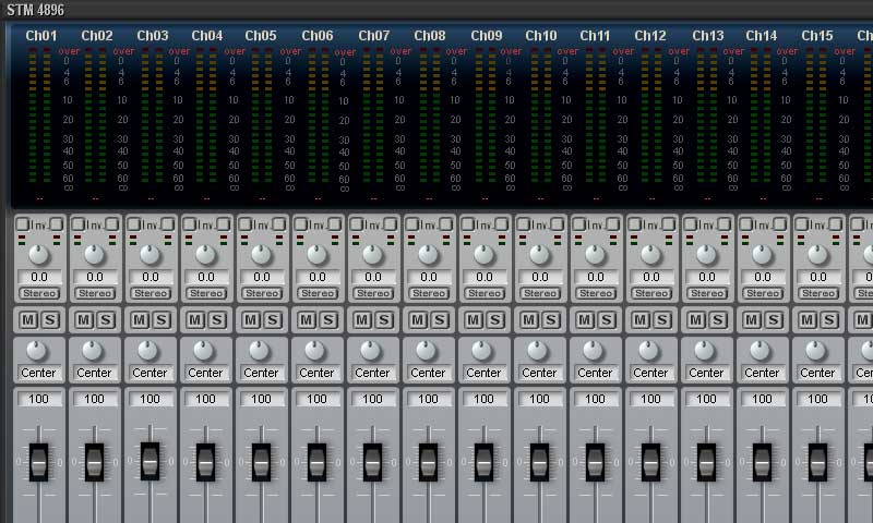

800 pixels is not enough for the stock meter bridges.
Posts: 7783
Re: mimo monitor as dedicated meterbridge for Scope
Indeed, was just making a screenshot and u beat me to posting. Still...for reference:
mimo monitor resolution

Two meterbridges would partially fit so that 2 x 26 channels of metering can be visible. I don't know if my 3 GHz P4 can handle more CPU load because it is reaching its limits.
