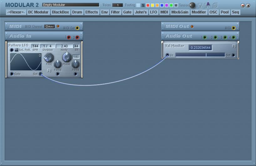

My question is in the topic, but here is a screenshot:
I can't connect LFO out directly to MIDI, which looks quite normal.
But how do you send a particular mod signal to a midi ctrl for some synth out there?
- ModLFO.JPG (42.32 KiB) Viewed 5381 times

you already answered your q yourself
by using a ValMonitor, plus right-clicking it's indicator / assigning a midi CC to it

Re: How do you get some Flexor LFO signal to the Mod Midi out?
you don't have to connect anything to midiOut; if you assign a midiCC, Modular's midiOut will send the values believe me

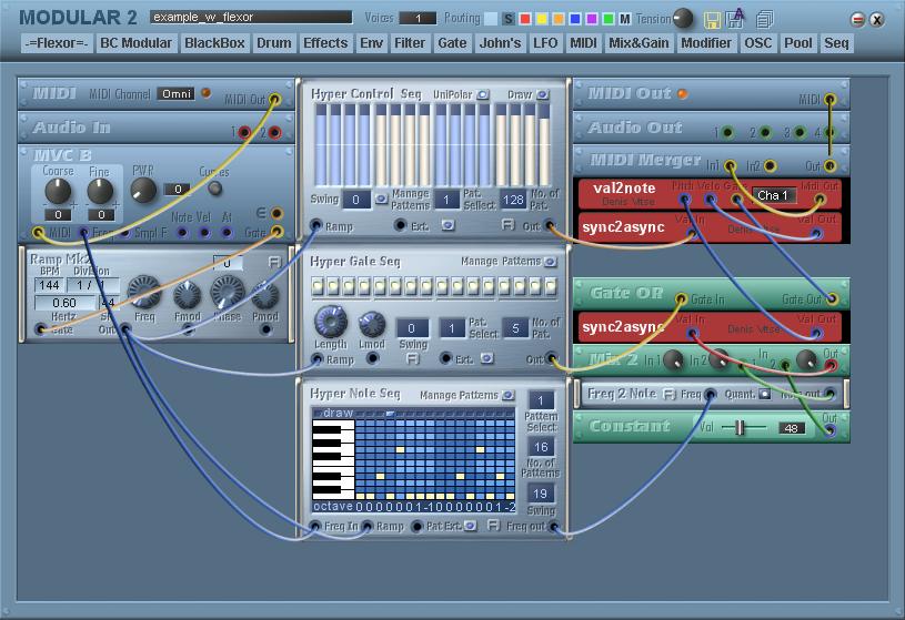

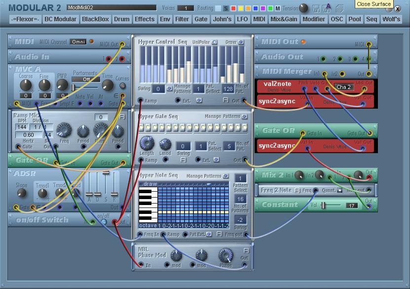

Ok, I've come with a basic Modular sequencer but now I stucked when trying to trigger the ramps from a simple midi note and have everything in sync.
Here is the patch: Thanks in advance for your hints.
I wonder if that's the best place for the Gate OR? Try moving it to between the MVC B and the Ramp module and see what happens.
Cory
Cory
...and send the Hyper Gate Out straight to the Val2Note...
Sorry guys,
the usual "booked with work" week.
Here is the next screen of my current mod patch:
This is what I found in the tutorial given by Wolf (the tut is called "example_w_flexor") and it looks like it is allowing me to connect to the Val2Note Gate signal. I tried to do without it there but I can't connect my gate seq to Val2Note Gate IN....and send the Hyper Gate Out straight to the Val2Note...
As I stated, I need it for linking Gate Seq and Val2Note Gate IN. If I add a new Gate OR between MVC and Ramp, it doesn't sound as it changed sthg.Try moving it to between the MVC B and the Ramp module and see what happens

The only other thing I can think of is replacing the Gate OR nearest the Val2Note with an async2sync...but that would mean that the second Gate OR was causing the problem, which doesn't really make sense.
Maybe Wolf will pop in?

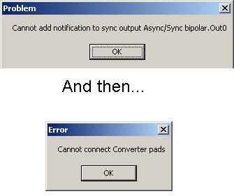

... Tried that.
Got:
Got:
Signal Polarity? If so, I think I've seen some modules that could transform...
..just coming back from the ranch (honestly)
IMHO using Flexor modules together with Wolf's val2note module doesn't make much sense. Flexor's advantage is it's precision = being very time-accurate. this is achieved by using "sync" dsp modules. so if you transform it's output by using a sync/async module, it's advantage is gone.
- you already saw that the HyperNote module makes problems when fed into the Val_In input of the val2note module: it's freqOut scale is different from a Control module's output. use a ControlSeq module instead.
so if you want to trigger an external synth by Modular seqencer modules, just use the provided standard Scope Modular modules:
CtrlSeq -> val2note Val_In,
another CtrlSeq-> val2note Velo
gateSeq-> val2note Gate.
If you really want to use Flexor modules, just use HyperControls for the two val2note inputs. (in the pic you see I used a CtrlSeqPSw module, which also outputs sync signals; I used it because it's "Random" feature.)
btw another nice Wolf module is "val2control": if a CtrlSeq is hooked in, it spits out MidiCtrl values which can control whatever Synth parameter you want.
