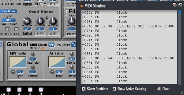

I have had clock working from Samplitude to Scope with v5. However, I just tried it out and although I've got the clock stream showing up in a midi monitor neither Solaris or Lightwave v5 will respond to it when external mode is selected.
Song BPM is 90 and external BPM indicator on Solaris jumps to 360 when activated.
Solaris is producing audio but we have no clock and no clue. My present theory is it's all down to sunspots.

I think the midi stuff isn't fully sorted out for V5 as yet
Re: Scope v5 Midi Clock
it's a bug in the actual RC that will be sorted out in the final release.
we're allready on it
