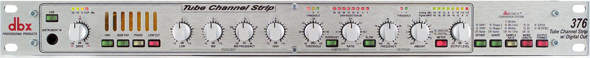

- Today I'm using the SPDIF IN on my scope pro to connect my dbx 376 tube preamp digitally. Fortunately, the dbx 376 also has AES/EBU, so my question is: is the xlr cable for aes/ebu just a standard xlr mic cable? is there anything else I have to pay attention to with aes/ebu?

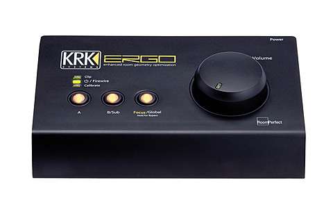

- I'm also using the SPDIF OUT, which is connected to my KRK Ergo Room Correction System Monitor Controller (which is ace and also uses sharcs btw :-)) Xite-1 has no SPDIF, has it? Is there any converter from AES/EBU to SPDIF like an adapter or cable or something? It would be a real loss if I couldn't hook it up digitally...

Make sure to buy an AES/EBU cable...not just a mic cable. 110-Ohm coax cable, is what you're looking for..

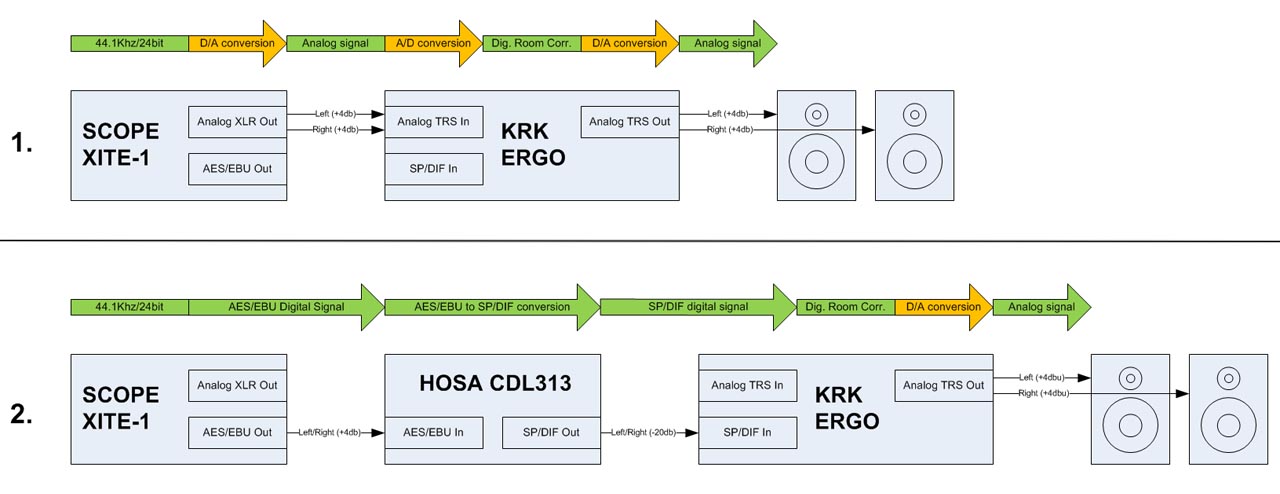

Now back to the topic again. There are two ways for me to hook up my monitoring rig, which one would you recommend and why?
1. Analog with AD/DA conversion back and forth
2. Digital with an AES/EBU to SP/DIF conversion
Thanks,
Roman

The only difference between AES/EBU & SPDIF is the signal strength...like -10 vs +4... :wink:
So staying within the digital realm (if ones monitors supports digital ins) is all ways best imho...

btw. I've got no digital inputs on my monitors...

There are others brands out there...It will take some searching, though...
Like these
http://www.mercenary.com/neditr.html
http://www.musiciansnews.com/recording/ ... rter.shtml
All in all...the fewer steps, connectors, converters etc etc will serve best...
