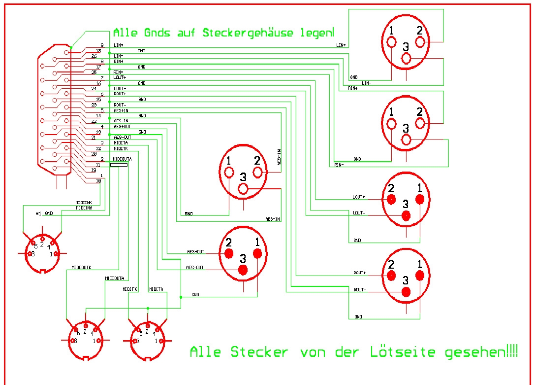

I got this off the ever reliable Ralf, attached diagram - it is a D-SUB 25 pins
D SUB Pulsar connector I/O

this is the wiring for a plus plate (symmetric xlr and aes). is your board a plus? I think I remember you saying spdif...
and btw, a standard db25 connector has 2 pin rows and is 53.4mm wide, while this one has 3 and is 39.2mm. this one has 26 pins, btw.
so you need either this male or this female connector.
(don't remember if the whip has is male or female. I think it was male...)
didn't find matching hoods yet...
-greetings, markus-

I will check, this is the diagram Ralf sent, I will look at making it up next week.
It is a P2 6 dsp card, with the lightpipe I/O etc.

geoffd99 wrote:It is a P2 6 dsp card, with the lightpipe I/O etc.
both plates (classic and plus) have double adat i/o. the plate itself is different, though. I expect a somewhat different wiring, too, since one has unbalanced analog i/o and spdif, the other has balanced i/o and aes/ebu.

Quite right, mine is an unbalanced one.
Re: P2 cable set - can it be made?
Best to ask Ralf if he's got a different wiring diagram for the 'classic I/O' cable. It may well be using the ground & hot pins in this diagram for the unbalanced analogue on the classic, but it's better to check rather than take any risks.

kylie wrote: (don't remember if the whip has is male or female. I think it was male...)
We are talking of the classic i/o right? Then it's female, but if you're making your own....choice is yours
Could you post up or pm the classic i/o cable whip schematic if you manage to get it from Ralf?
I found a picture of the Z-Link plate in the manual. the plate I/O connector is female, so the whip plug has to be male...
afair the classic plate and the Z-Link plate share the same whip. I don't expect the plus whip to be crafted vice versa, especially not because they say in the manual:
"Since the circuitry of the Classic and Plus I/O is different, it is not possible just to swap the cable whip".
and since the connector on the board is soldered to it, there is no "the choice is yours" , even if I make my own cable... :wink:

Yes it is male, I have the card here.
Ralf only has that one diagram shown above.
