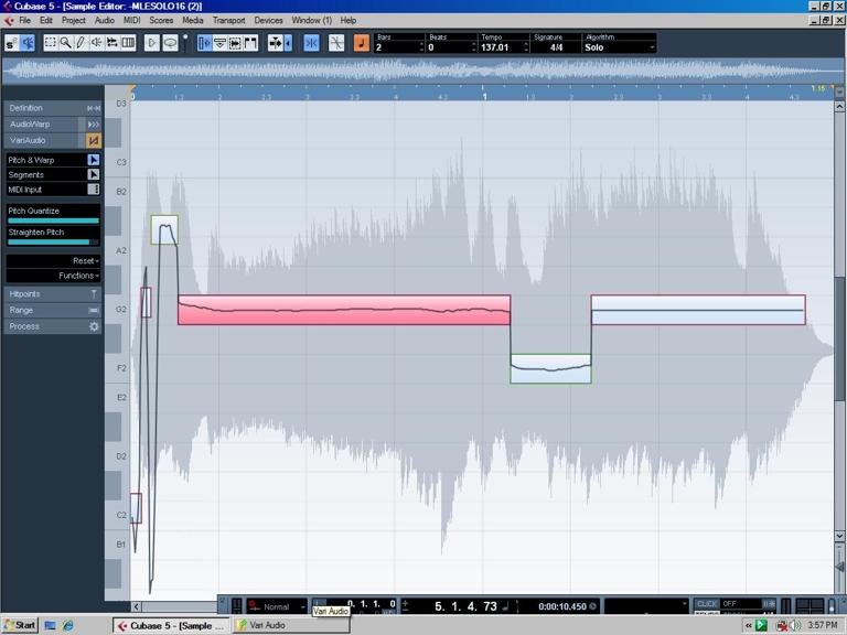

Today I spent mostly using the "VariAudio" function in the Sample editor. It is similar to Auto-Tune although I haven't used Auto-Tune so I could not tell you how it compares. I found this function to be very good and easy to use. Even if you change the pitch by an octave, it still sounds fairly natural. You can vary the amount of pitch correction a little or a lot. At the highest setting it sounds like the overused Auto-Tune effects in techno and hip hop recordings. You can also export the audio as a midi file (select "functions"). I was skeptical about this but it worked perfectly. There is also a plugin which has a similar function to "VariAudio", it is called "pitchcorrect". This is a simplified version of the same thing but it also offers formant controls. Both methods allow you to use a keyboard to alter the pitch if you wish.

In the image the red part is selected. You can see I set the "straighten pitch" option to about 90%. The last part shows it at 100%.

- VariAudio.jpg (191.11 KiB) Viewed 4347 times

2. Pitch correction has had quite an impact on the sound. You can certainly here the pitch correction and also some weird artifacts in the tail right at the end. I also haven't used autotune so i can't compare to that. But I do use melodyne which does a very good job IMO. You probably wouldn't be able tell the difference in a full mix anyway!
