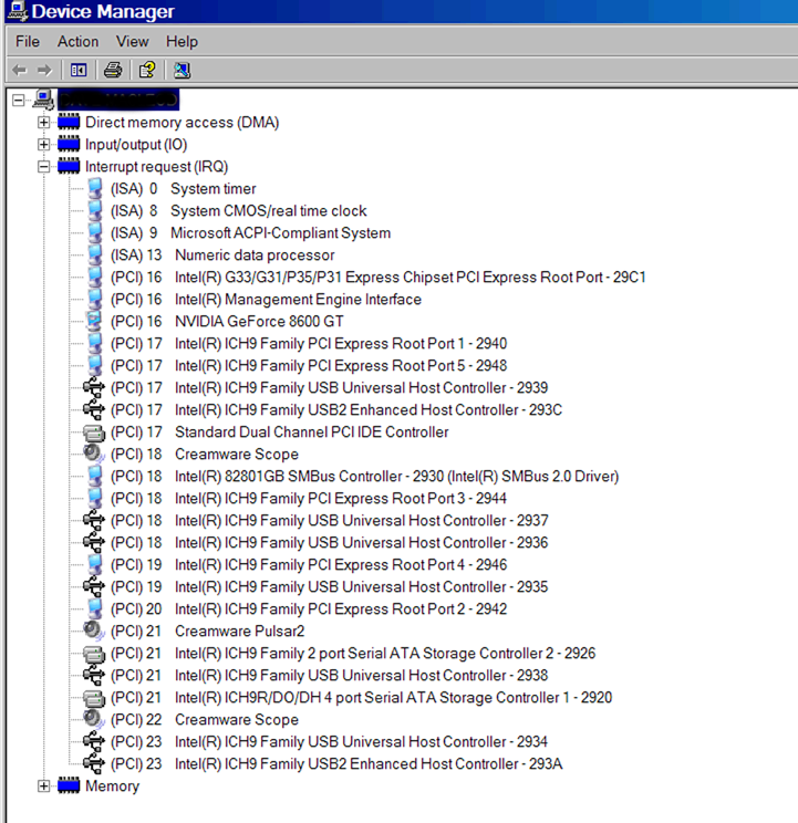

After seeing a post where a user was using three scope cards in this motherboard (DP35DP), with no shared IRQs, it made me want to try to get a better configuration out of my system again... So, here it is:
IRQs / Devices
21 Creamware Pulsar
21 Intel(R) ICH9 2 port Serial ATA Storage Controller 2-2926
21 Intel(R) ICH9 4 port Serial ATA Storage Controller 1-2920
21 Intel(R) ICH9 Family USB Universal Host Controller-2938
22 Creamware Pulsar2
That's what I have by now, and you can see that it sucks! I think that's why I still get some PCI overflows from time to time in some very big and complex mixing jobs I'm doing.
Can someone share some light in how to force my system into using the free IRQs I have available? I can't disable the USB controller, because Cubase4 needs it for the Dongle (!).
I've tried many different PCI slots configuration for both my cards, and this is the best IRQ config I can get. Also, I can't seem to be able to disable just SOME of the USB ports. It seems I have to disable all, or none, in this motherboard? But disabling some USB root Hub devices in the Device Manager won't make any difference in my assigned IRQs anyway.
Scope is almost the perfect thing for me, and if it worked with my new system I've put all my money in, it would be perfect, because you know and I know, there's nothing else out there in it's league, but when I get PCI problems, it's still a just one more :-?
Please, if you have any ideas, HELP!!! HOW DO YOU GUYS DO THE MAGIC WITH THE DP35DP???

Try to place your primary I/O Pulsar into the PCI slot that gets assigned to IRQ22 - I think it's the bottom slot - so that card doesn't share.
You may have to configure your cset.ini file so that the IRQ22 Pulsar is board0 - the manual details how to do this.

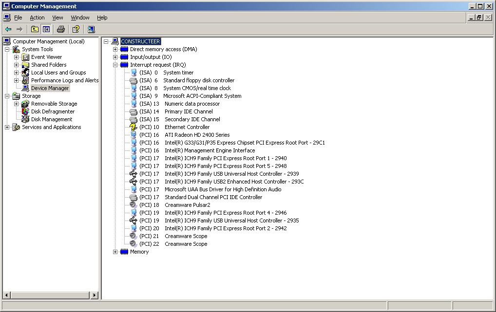

I have three Scope boards in all three PCI slots on the DP35DP. Two of the boards share irqs with numerous devices, similar to what you listed. As long as board0 is on its own I'm ok, even with a full DSP load.

So you have the Pulsar2 in PCI slot2 getting irq22, unshared. Good start.
Did you try moving the Pulsar1 into PCI slot3? That will (probably) assign irq18, sharing with PCIe root and usb 2937 & usb 2936, which shouldn't be a problem but either or both usb can be disabled in windows device manager. (I didn't need to).
You may need to edit cset.ini to make the Pulsar2 in PCI2 [board0].
I have my bios HD setup to run sata drives as IDE (because of the "no floppy disk drive" issue), but SATA controllers still occupy irq21. If you don't use PCI slot1 you can avoid irq21.
Don't worry - this CAN work, and the Scope system is worth the effort.
With Gary on the case I'm optimistic you'll solve this problem.
/dave
device irq copy.png (210.82 KiB) Viewed 4448 times

Well, according to the DSP meter it shows the first card as a six DSP card, so it seems to me that it means my first card is the PulsarII, and it's alone on IRQ22, as it should be. BUT, according to the "regystry" window on scope, it shows PulsarI (four DSP card) first in the list, so who is righ here? Should I trust DSP meter or regystry window?
Also, I've tried changing board0 parameter on CSET.INI to Host (as it were originaly), 0 and 1... And strangely none of these parameter give any changes on the DSP meter OR the regystry window. Six DSP card is ALWAYS first in the meter and second in the regystry window, even after reboot of the system, so I've left it as Host as it were originally.
Also, yes, PulsarI version16, the slave card (as far as trusting what DSPmeter says) is on IRQ21, sharing ONLY with two SATA controllers:
The USB ports it was sharing IRQs with is now disabled in Device Manager.
Yes, tried that, and as far as I recall now, changing it to slot3 makes it worst, as it shares with SMbus controller and four more devices, and the same PCI limit error keeps popping, and if I recall, on PCI 3 it was assigned as IRQ17. Maybe different MOBO revision???
Anyway, changing boards around on the three PCI slots was done like twenty times, and I don't see me trying that again... :o Maybe different MOBO revision??? At least I get a free master board on IRQ22 as it is. Maybe the PULSARI version16 is what is causing problems in my system? Should I go all the way and try making it a PULSARII or a LUNA version32 also? Would that make any difference?
I tell you guys, it's really strange, 'cus it only happens when loading the CUBASE associated project, so it really seems to be an obscure issue with Cubase 4.5 software, maybe???
