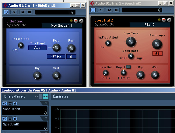

Re: 3rd party plugins
Hi Music Manic,
The spacef filter won't crash , they load fine.
I managed this only by putting them in existing folder of xtc, and using a dll of this folder (I've put them in the "Filter" folder of the vst plugins/xtc and used a dll of one of the devices in the filters.
I think only the location is important, but i have to test further (i've put them in different locations first, at the root, and they didn't crash, they just "cannot load" ).
I have been able to load them either on mono or stereo channels (i've put them also in stereo folder of xtc).
In the Scope folder "XTC Devices", i've copied the whole Mono/BlackBox folder in Effects/Mono of XTC Devices folder.
In the picture, the sideband1 uses a dll found in the Mono filters, and the Spectral 2 uses a dll from a stereo folder...
Both load indifferently in mono or stereo channels of Cubase.
Most of the SpaceF filter have 1 audio input and outputs the signal on the 2 outputs (L/R) so mono to stereo is possible (same signal goes to L and R).
The second input of the spacef filters (in2) is for modulation, and doesn't go to the outputs: this 2nd input is calibrated for Scope modulation signals, not audio in all cases (in some cases only, but need to check again).

- Hey, it doesn't crash, it seems to load fine....
