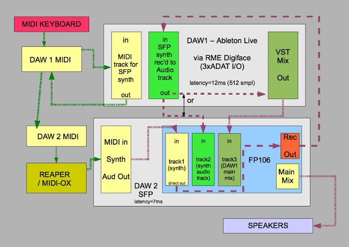

Hi all. I was hoping you could help me find a way of solving this latency problem I'm having. Here's a simplified diagram of my studio, to help describe what I need to find out. There's a main DAW, with Ableton Live as Audio/MIDI sequencer, connected via ADAT to a second DAW, where Scope resides. Although there is a monitoring path from DAW1 to the speakers, I usually mix and monitor everything in Scope, as you can see in the picture. This way, all external synths and modules, all SFP synths, and all VST tracks (audio or instruments) are summed in the Scope mixer (in this case, SpaceFs FP106).
latency 2.jpg (52.69 KiB) Viewed 7598 times
This works pretty well for playing and composing. SFP's synths behave like external modules, and doing things like having DAW1 playing a Drum loop and triggering a bass in SFP is easy and the sound "locks up" pretty well, as the ASIO latency is compensated inside Ableton for the audio and MIDI parts, and the SFP latency introduced is the same for the ADAT inputs and the Synths output.
The problem is that DAW1 is where I do all recordings, so when I want to record the bass sound back into Ableton, I use the record out in the FP106 (orange square in pic) to send it via ADAT to an audio track into Live and record the output - but the delay introduced in the signal is quite significant!
In the image, you can see this graphically: in yellow is the normal path: MIDI is triggered from Ableton into a Scope Synth, then to a mixer, blended with the other audio and then to the outputs. I want to record that path and replace it with the green path, but maintaining the timing.
What I need to find out is if this delay is consistent, and if it is, how I can calculate it. I would expect it to be:
(ASIO latency for MIDI)+(SFP latency for synth)+(SFP latency for output)+(VST latency for recording)=total delay, which means in this case: 12+7+7+12=38ms, but introducing that in the "track delay" doesn't solve the problem, and pushing the star point forward 38ms is not the trick either, so something must be eluding me.

EDIT: OK, so I figured out a way to measure this. I make the recording into ableton, and activate both yellow and green paths (playing the MIDI sequence and the recorded audio) at the same time. Using the direct outs, I can tap both signals in the FP106 and send them via ADAT to separate inputs on DAW1, record these with the RME's built in Wave recorder, and compare both files in Wavelab. This should give me an accurate measurement of the difference between both signals and, after checking out with different synths for consistency, it will enable faster bouncing of synthesized tracks to audio.

Hi Neutron. Thanks for the input. The problem I was having in Live is to measure how "off" the recorded signal is- because it doesn't have the fine measuring that's on Cubase, for ex., where you can get a reading for the length of a selection. In Live, you can drag the start points of the loops to compensate, but you have to do it by eye / ear (which is on of the major downpoints of this app). That's why I was thinking of recording both signals to separate wavs on the end of the path and compare them in Wavelab.
