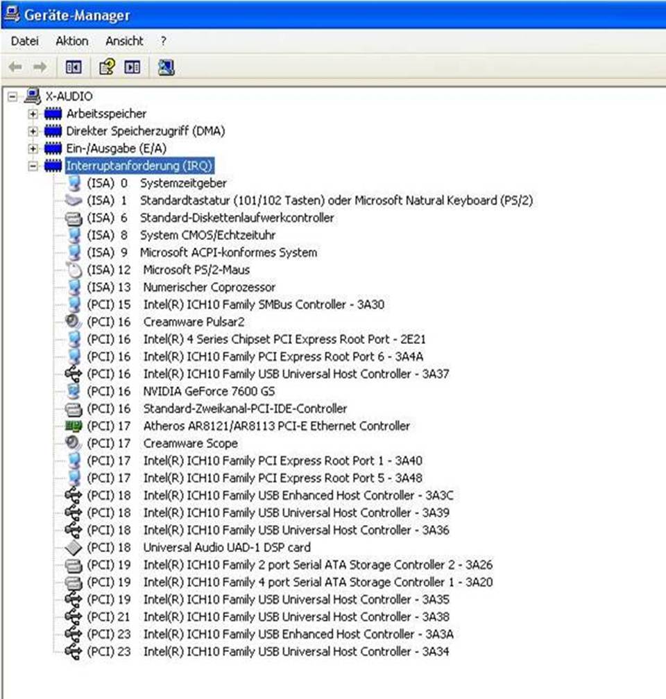

I´m using the P5Q with E8200 and 4 GB G.Skill Ram. Very fast and stable system. No problems so far
IRQ P5Q3.jpg (116.4 KiB) Viewed 2532 times
Re: New DAW Configuration for about 800 EURO (Juli 2008)
Nice helpful pic Brotha' Man Thomson. :wink:
I use the GSkill 4GB DDRII 800. They are of high quality and reasonably priced. BTW, those Asus boards overclock really well if you feel the need for more speed.
Or upgrade next spring when the E8600's are cheap. The 1333MHz @ 3.3GHz is a perfect match stock combo. It's my next move before Christmas.
More important note, get Scope running as soon as possible. :D

thomson wrote:I´m using the P5Q with E8200 and 4 GB G.Skill Ram. Very fast and stable system. No problems so far
wow, thanks a lot thomson, this makes me feel i'm on the right track.
the only reason I would choose for for the Deluxe is that that one has that new 16 Phase power. that could be some marketing hype but it is designed for these processors.
if I look at the configuration of the Deluxe I believe i cannot put 2 SCOPE 6 dsp boards in that one since the second PCI is very close to the first PCIe (used for the videocard) and I think that the memory banks are to close for the scope to fit in.
thomson, you may see real problems in the future depending on how you use your system.
the pci-e root controllers sharing irqs with Scope cards are troublesome, but the usb controller that is sharing should really be turned off!
