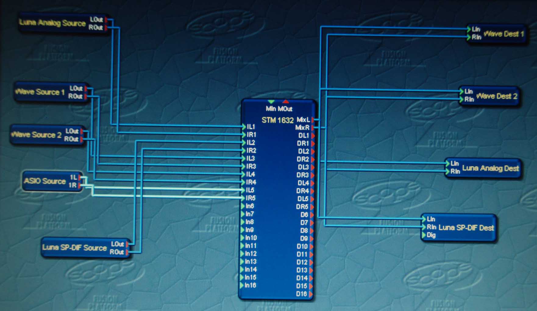

The 01X is Yamaha's mLan mixer/interface/control surface that uses the mLan Firewire style interface. I'm not convinced that there is an ADAT option, but it does have SPDIF and Optical for 2 channel i/o. You can connect the 01X to the Luna via the SPDIF input then use the Scope SP-DIF source routed to an ASIO2 destination into Cubase. You'll only be able to record 2 channels at a time as the19thbear said.
Stratt
Stratt
- Here's an example of what should work
- SPDIF-ASIO.JPG (5.85 KiB) Viewed 2550 times

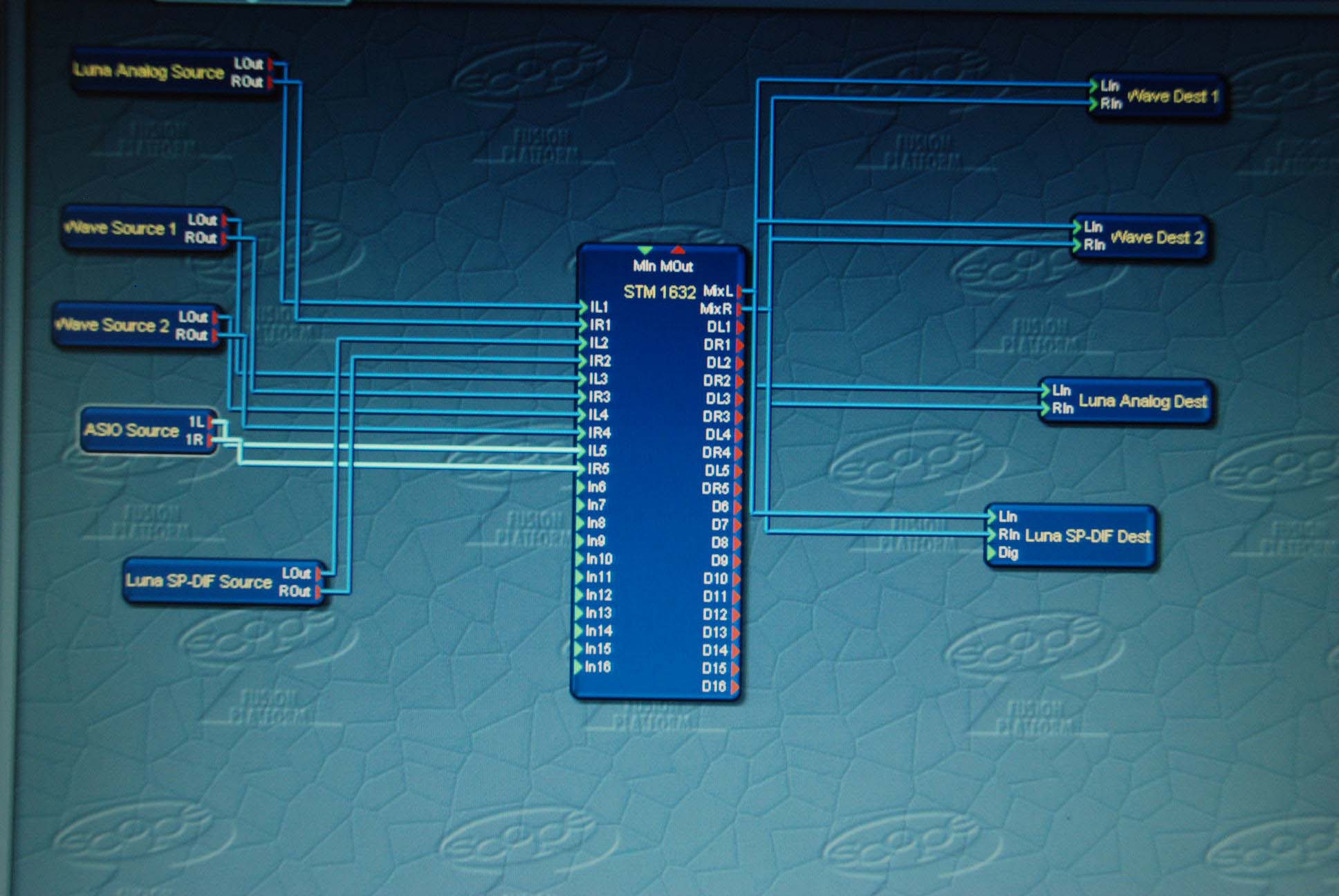

Hi
Here is a screen shot
Which ASIO module is the Yamaha 01x , knowing that i am using the digital in/out of the Yamaha into the scope. Cubase and other sound is playing back from the computer into the mixer out thorought the monitors.
But i cannot record into cubase
- scope.jpg (195.1 KiB) Viewed 2485 times
