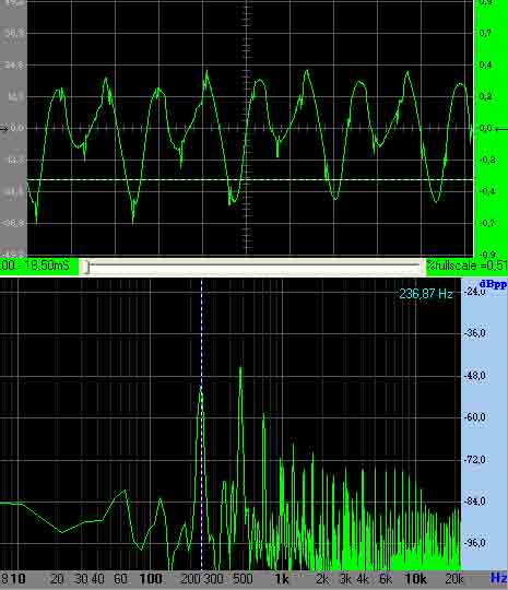

Ok, I just had the Philips TFT here to make some try.
1) the noise is going on whatever orientation the AC plug has
2) no noise on the DAW using the monitor with the other PC, connected to the same AC socket
3) the pitch of the noise don't change using different refresh rate
4) the noise is present at Luna box output even if SFP ain't running
5) the noise do is present when the screen is black but the backlight is on, it disappears when backlight is off
these are waveform and spectrum of the noise I picked up at Lunabox output:

Something very similar is happening here with the Philips 170S. Just the noise fundamental freq is lower, as you can see.
I just checked the screen in a ordinary PC configuration (onboard audio + Creative 2.1) and there's no noise...
