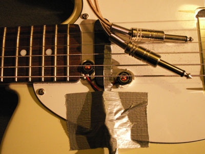

Couldn't resist. At least it "works".
LISTEN
http://www.planetz.com/phpBB2/download.php?id=2863
The non polyphonic version works MUCH better so far.
Non polyphonic: http://www.planetz.com/phpBB2/download.php?id=2858

Thats cool, i am thinking of making a synthesizer for guitar to midi setups, 1 chan for each string. more to compliment the gutar sound and do pads though due to guitar to midi slowness (on my vg-99 anyways)
by the way those single string pickups you made, are they just some magnet wire wrapped around a screw or something? how many winds and what gauge?

Neutron, nice to finally have a little chat with you! I have a dozen of those coils as I once ordered wrong stuff from an electronic-shop. I kept them in a small box and now remembered... I also thought about a line6-ish solution with piezos, but as I need as much bottom & less high mids as possible I thought it would be easier this way. They fit perfectly in size & I was surprised how much and "nice" sound comes out! Don'tr know how they were called though...
One of the main problems seems to be kicking the gate for OSC while playing guitar the dirty way. Monophonic it works nearly "perfect", the polyphonic needs some adjustment.
MIDI is exactly the next step I have in mind. I think it shouldn't be difficult with the monophonic version. After that we'll see. Polyphonic is more an experiment - if I really want it I'll buy some roland stuff too, but the monophonic version really pleases me & it's really fast!

actually one can use whatever coil (or combination of coils) is available and there will be some usable output... some more, some less.
but for midi note detection the single piezo elements under the strings seem to have some advantage. Afaik they aren't expensive at all, but you may have to change your bridge... :(
with one coil per string you have essentially the same as a Roland hexa-coil
if you feed it to a multi-channel input, you should be able to do 6 mono note detections, and that's poly then.

Those coils were nice and big though. and they are going to be output rather than input device. (think of an "e-bow" for each string with a key or button and its own amplifier) i already have an old roland hex pickup for the input.
maybe i will even make the keys triggerable from MIDI for some robot guitar :D

Nice gaffa tape there Martin. :D
