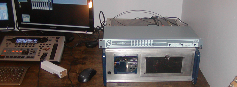

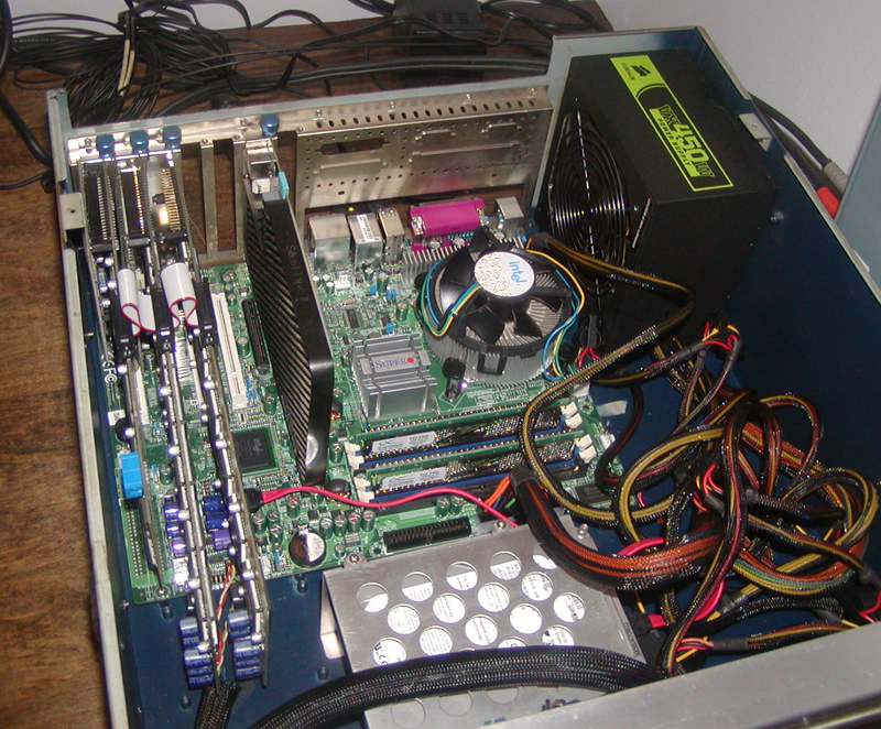

Neutron
Posts: 2274
this old case is still great.
Post by Neutron »
you can find them cheap sometimes, they need a bit of modification to get lots of free space, take out crap i didn't want etc.
it used to be blue.
more work is being done on the front bit.
change to a scythe ninja heat sink as soon as i can find the box with the adapter bits :(
and machining a new card holder. etc etc
it has rack ears i have tio put them back on
look how much stupid wire comes with that power supply. i only used 3 of them :)
