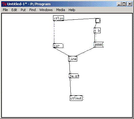

However, I made my first successull midi smoother in PureData! Probably not smooth enough but its working, can learn & assign the midi cc just fine :)
Its pretty cool! for a firs try :)
It looks pretty ugly! You can see the incomming CC already on 127 while the outgoing i still getting there!

Ok I changed the midi routing into scope a bit, its working better now!
I have 5 midi fades running with various speeds and the CPU stays under 20% most of the time!! :)
FrancisHarmany
Posts: 1078
Location: Haarmania
Post by FrancisHarmany »
Partly, I havent tried the scope midi tools with this setup.
What I routed the signal thru usb -> midi-ox -> scope -> puredata -> scope which caused some extra cpu. Changing it to puredata -> scope saved some CPU.
I also think the USB driver of my midi controllers is party the problem, so I will have to test with direct midi connections into scope!!
Currently I think I will need a seperate midi control box. I have yet to decide how I will route the midi signals from MidiBox -> Scope DAW.
Perhaps its best to use normal midi cables ?
Or midi over lan perhaps ? I could even have PureData transmit the signals over LAN I think........ options options... choices choices...
I think I can route 3 midi cables into my scope cards, should be enough. but maybe midi over lan is faster ???

hopefully next week I will have my new hardware + fresh installation. Should clear up alot of troubles!! (DP35DPM. duocore 3+ ghz and 4gb mem!!)
Astroman: its definitly a problem with the midi cc's being generated inside scope! it seems stuff like puredata, or that Toby MCC stuff will do a better job (thanks for the link).
I guess it might save cpu if we have a module which only outputs 127 steps, and only generates CC when the output changes. but perhaps thats already how it works under the hood.... I have no clue :roll:
