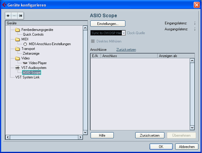

I crossgraded recently to cubase 4.1. I've tried to set it up with scope asio drivers, but none of my attempts was succesful. I'm able to select "scope asio" as audio system, but then there are no E/A-Connections shown. I've tried about every "Asio" thingy that scope offers in turn. Same result for each of them.

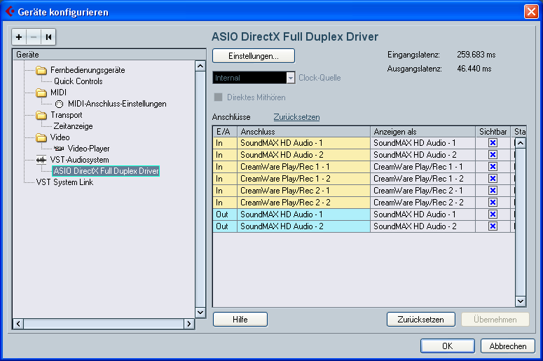

The only way it works halfways is to connect with the "ASIO Direct X Full Duplex Driver". Then again there are two strange things:
1.) Even if I have "24 Bit Wave Source/Dest" in my Scope Project, the "ASIO Direct X Full Duplex Driver Setup" program just displays two creamware entries with 16 bits only.
2.) I only get scope inputs and no outputs.

I've allready selected asio scope in cubase, BUT that does not give me any IO-connections (s. 1st screenshot) whereas "ASIO DirectX Full Duplex Driver" gives me several IO-connections. So selecting ASIO works, but doing anything useful with zero IOs?
If I select the DirectX-Stuff on the other hand, cubes offers me only scope Inputs. There are no outputs (2nd screenshot).
DirectX selected: showing only inputs
ASIO selected showing no connections
