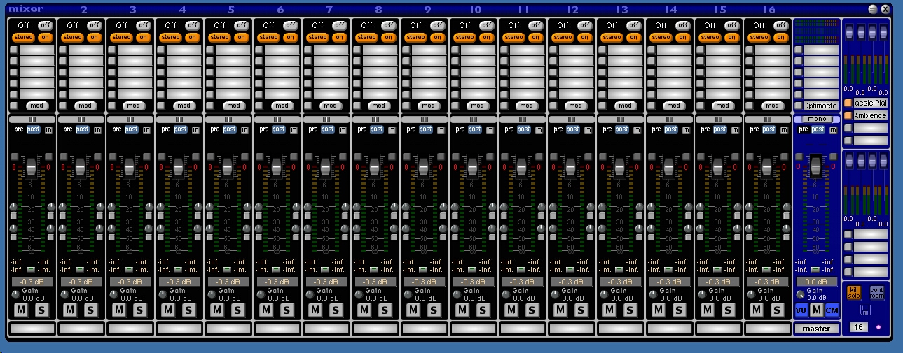

Yo, couldn't resist to post the news I got per email, the new mixer from Wolf:
http://web.mac.com/wrueter/wad/devices/ ... Mixer.html
look at those colors Jimmy!
shure, here you go. It's a pic of an older version, though. Some things aren't shown there like mute/solo groups, midi setting button, etc.
However you can download the demo and enjoy it colorless, too :
http://homepage.mac.com/wrueter/dev/16ChaMixer_demo.zip

Arela, basically mixing uses dsp-power .. the more you mix the more dsp you use.
So I guess your question is more about how much dsp is used.
This depends a lot on how the mixer is used.
One of the intial goals was to have the perfect dsp consumption (this directly corresponds to the 2nd thing below), so I designed each channel in way, that special "areas" of it will be unloaded from dsp, if not used.
I.e. if you use no inserts, each channel actually uses the same or less dsp amount like one channel from the STM series. This changes as soon as you insert fx and start to use busses and custom midi assigments, etc.
Another thing is how much of your available dsp you can really use. As you might know certain parts of the circuit need to be loaded onto one dsp to assure phase coherency.
So if such a "circuit-part" doesn't fit onto dsp4 it says "ok, I'll go to dsp5", leaving some unused "computing-place" on dsp4. This can add up to 20% or more unused dsp-cycles of the whole setup and although it looks like there's still some free dsp left you're unable to add other stuff simply because it doesn't find enough free place on one dsp.
The 16 Channel Mixer was designed to use up to 95% dsp (even 99%, depends on inserted plugins), the STM series drops out at around 80% from my experience. So even if mine uses slightly more dsp, there is no real difference in actual usage.
The 32 Channel Mixer is a bit different in that regard. It needs to load channel 17-32 onto a 2nd board (thus it is a requirement). Otherwise you wouldn't be able to use all channels. I consider this a minor issue since mixing with 16 channels already needs two boards, when doing serious work.
Still you should be able to fill your dsps up to 95 % or more.
Coming to an end of this lengthy explanation about dsp allocation: there is no real "this one uses more/less dsp than that", it depends a lot on actual usage and the flexibility of the internal design .. and last but not least as Jimmy says sound is the final judge.
