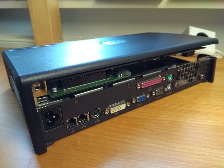

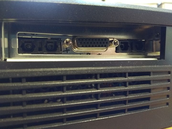

So my adventure with the Magma PCI Extpansions didn't work out. Well old hardware, but to many versions/variations of those expansions... I was never sure is the box, cable, interface and so on working or not... Then the adaption to my expresscard-interface of my laptop... ;/
I also tested a Dell D620 Laptop with a docking station. The docking station has to be modified mechanically. The thing is, that this combination have a very low PCI performance, So I got PCI-Overloads very quick.
Also back on my huge NZXT-Tower with good old Gigabyte-Mobo... ;)
Cheers, Andreas
