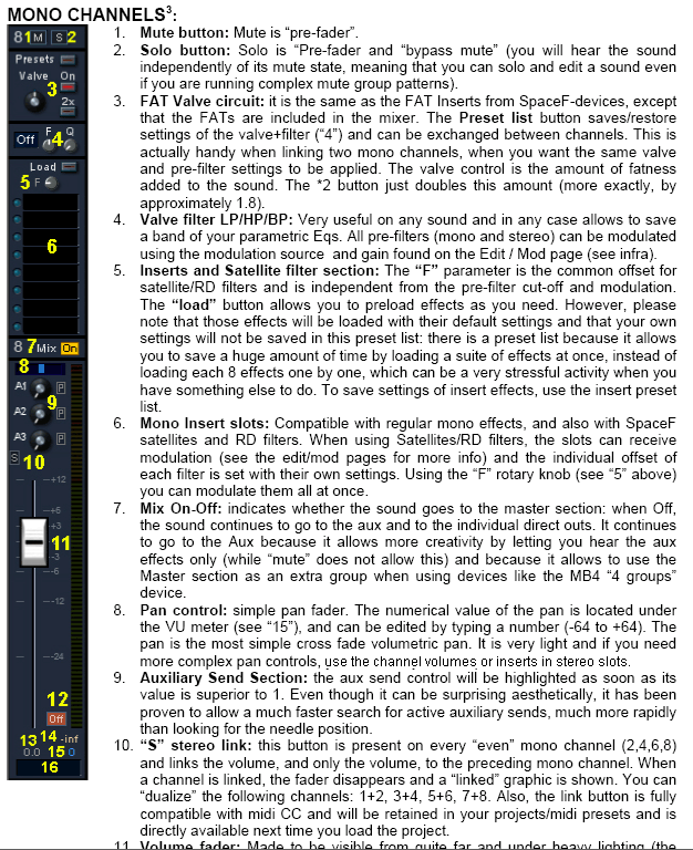

- Mono Channel description (extract)
- FB5mono.gif (95.78 KiB) Viewed 14507 times

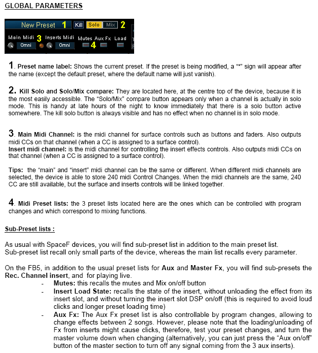

- Global parameters. Kill solo, Solo and Mix compare (when solo is on, to A/B soloed sounds alone/in the mix)
- FB5-Global.gif (51.21 KiB) Viewed 14528 times
