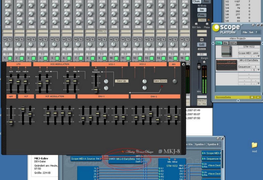

I found the time and inspiration to do this in the end.
Its far from being close2release, but at least the solo mode works half decent.
So here you have a first look on the design, which is also a pre_design and may be changed too.
:P
most of the important stuff is still missing, like keyfollow stuff, modulation, integrating better sounding saw oscillators and so so ....
But now I am relative sure, that it will see the daylight soon or l8er.
I don`t know how good I am at making it fine-sounding, but lets see.
Don`t expect too much, but if it turns out to be perfect sounding, then its fine too.
The problem is: the "free sdk" seems downgarded and gives no options to build in antialiased stuff like high class filter, which I would like to add.This seems to be an priviledge for guys like RED or for sure Soniccore themselfes.
It should be possible to add the dual mode later, the split mode is of less interest as it can be easily replicated by two instances and a midi key splitter or so.

inspired by the origin, but I guess it will be my own signature sound at the end, so no 100% 1:1 copy.
Lets say a similar architecture.
But I may extend the features at some points and cut them down at other a bit.
In digital world you can build in more feature at no cost. :P

Jimmy, I am exactly with you.
http://www.planetz.com/forums/viewtopic.php?t=22839
And I think for a monophonic synth I could integrate the ins and outs to integrate an external analog hardware filter without bigger problems.
I think it would be more difficult to adress more than one voice and the different filter in and outs, as I think there is no single adressing of voices possible.
But I didn`t look into this too carefully.

scope4live wrote:Good,
When can you get started? :roll: :D
Jimmy, do you have the external filterbox already?
so I would add you as a beta tester.... and we could try to integrate such a feature.
I would add a switch "hardware analog filter" and you would have to connect certain MKJ-8 filter ins and outs + envelope output to the filter_mod.
But at first I have to work a bit more on the basic structure. :wink:

Jimmy,
keep in mind we have no prove that it works at all. :lol:
The Sherman could be fine for doing a test.
What inputs and outputs does the sherman have? only audio in/out or also control signals.
if I look at the shippmann filter it seems like the envelopes can be triggered to gate signals. If the creamware gate module can send a compatible gate signal to the box (which has to be proven first) you could trigger the analog filterenvelope to the software synth via an audio out.
http://www.schippmann-music.com/ebbeundflut.html
the routing would be
softsynth (both outputs as pads on the soft synth)
-audio out (before filterstage)
-gate trigger out
both these pads should be connected to 2 audio outputs
back on softsynth there would be inputs for taking audio signal back into the softsynth.
The other option would be to use the digital envelopes from the CW synth, routed to audio outputs and then into the VCF of the shippmann.
I`m pretty sure that this would work.
The Shippmann is very expensive, so we have to find a filter that is relative cheap and also has inputs for controlling the filters via audio signals.
It doesnt make sense to build a hybrid monophonic synth around a 1200€ filter, as you can find a full monophonic analog synth for the same price also.
We just need a filter that has audio in/out and a vcf_input for a low price.
Problem is the cheap ones only have audio in/out, so they are useless, the more expensive ones don`t make sense for a hybrid_synth in terms price/useage ratio.
polyphony should be almost impossible without the help of Soniccore themselves, as you would need voice adressing intelligence inside the synth.
Waldorf has done this on the AFB, but it was problematic due to the usb bus, which introduces a latency. At least it did work.
BTW, why don`t Waldorf and Soniccore team up to build the oversynth.? :D
They both have knowledge that would complement quite well.

I`m sure the filter CV(I guess control voltage?) input is for an envelope trigger signal to control the filter cutoff.
We only need to know if the voltages of an A16 or pulsar out are proper to drive the max control voltage of the filter in.
But a simple amp module could do the trick.
You make sure to kepp me posted, I am watching this thread.
