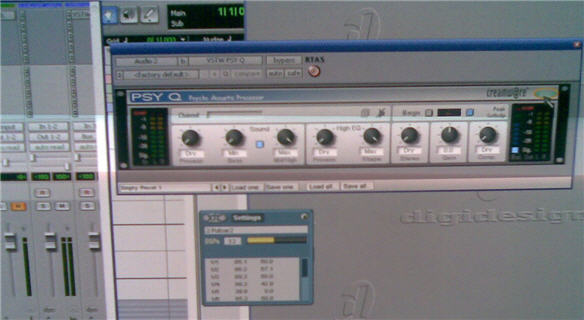

can some one post the picture.
is it like tcpowercore or uad in rtas mode.

some one put the pic, please.

cjgt
Posts: 10
Joined: Mon Dec 17, 2007 3:04 am
it works fine.thx
Post by cjgt »
look pic.
