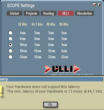

Hi all,
I have the following computer configuration:
CPU Athlon 2700+
MSI Motherboard
1GB DDR RAM
2x200 Go SATA HDD with RAID1 (400Go)
1 ATI Radeon 9600 series video card
1 Scope Professional 15 DSP audio card
1 Firewire TC Electronic Konnekt 24d audio card
(Firewire, RAID and Gigabit controllers included in mainboard)
I have the following problem:
I can't setup ULLI to go under 13ms at 44.1KHz. I have the message:
"Your hardware does not support this latency. The min. latency of your hardware is 13 msec at 44.1 Khz"
Would it possible that a Scope pro board couldn't function with lower latencies than 13ms and 44.1?? Anybody did hear about series of Pro cards acting like that? I'm asking as I bought it 2nd hand on eBay during August 2007 but been sent back to sonicCore for a repair during september...
If anybody could tell me if it's a possibility or not, than a Scope Professionnal board couldn't have lower latency than 44.1 - 13ms...
Denis
CPU Athlon 2700+
MSI Motherboard
1GB DDR RAM
Denis
- PbScope_v40.JPG (18.07 KiB) Viewed 3438 times

my rule of thumb from the Masterverb test thread
1st generation card (ULLI not possible below 10 ms) is 100%
a (additional) 2nd generation card will double the PCI performance
2nd generation only cards would add another 30% improvement
