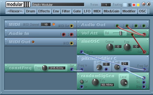

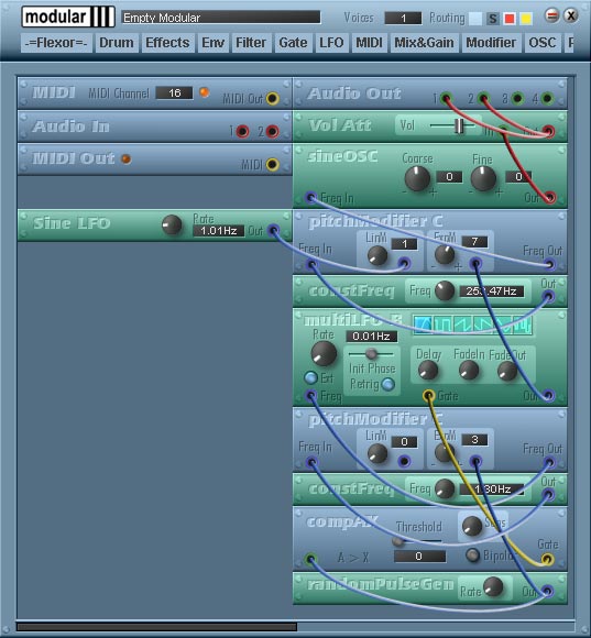

Hi,
you could experiment with something like these (the second option if you like complications).

Sorry, the second patch uses ModIII modules RandomPulseGen and Compare AX.
It escaped me at first read you're using version 2.

thanks anyway! i get the point with the modular 3 setup.( but not the modules :lol: ).. maybe i can fiddle around and make a similar setup with mod2, or use the more simple version..
thank you very much! :D

I used a sine OSC for check it out, but it could sound better using other waveforms or a resonant filter modulated directly by the random signal generator, as you said.
Parameters setting is not that easy, however, even with the sine config. It tends to bark...
